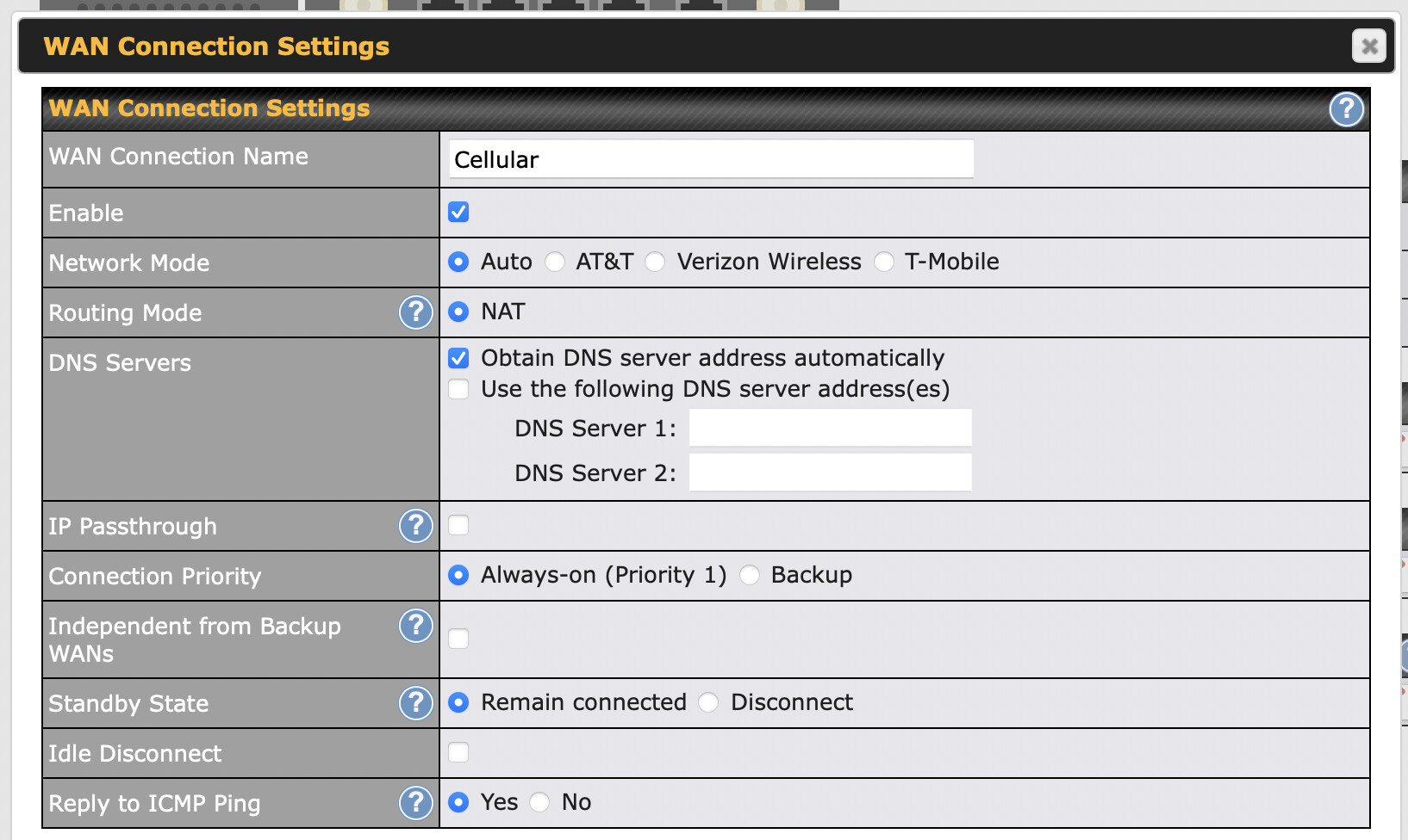

I’ve purchased a new Max BR1 Pro 5G and am now using that in this same scenario. I’m still using two different SIM’s (Verizon and AT&T) but I never use them simultaneously or bond them so the Max BR1 will be great for this application still, and a little newer/faster.
The BR1 Pro gives me the IP Passthrough option on the cell connection, so that is now back on the table as an option. It is not currently enabled though.

My SIM connections are still exactly the same, meaning I still have no public/static IP’s. so is IP Passthrough even beneficial? I guess it would disable NAT correct?
With this new info/update, is using IP Passthrough the best way to go about this with my UDM router? Does that even matter since I’d be now getting my public/static IP from the FusionHub?
On that same note, does it matter if I disable NAT from the BR1 vs disabling it from the UDM? or as long as it’s disabled on ONE device then all is equal?
