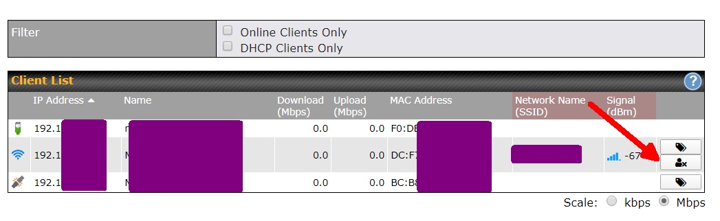

In the client list, there is a new (introduced in firmware 8.1?) gray button on the far right side that says “Ban Client” when the mouse hovers over it. What does this do? Its not in the Balance User Manual.
Yes, it is a new feature in 8.1.0. It uses to disconnect the Wi-Fi and Remote User Access clients manually. Please refer to the release note - https://download.peplink.com/resources/firmware-8.1.0-release-notes.pdf, reference 22516.

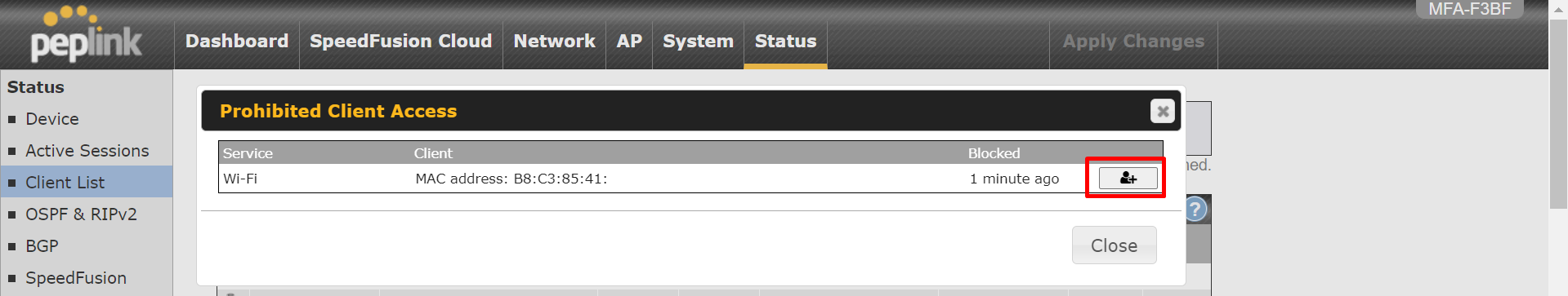

There is a blocklist in the same page after you banned the WIFI or Remote User Access clients.
You may unblock the client when it is needed.

I tested this with my iphone with Private mac disabled. I banned my iphone, and noticed it almost immediately lost wifi connectivity.
I enabled private mac address, and quickly reconnected under a new “private mac address”.

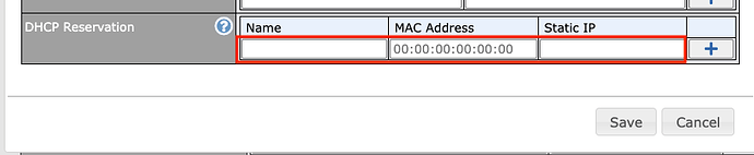

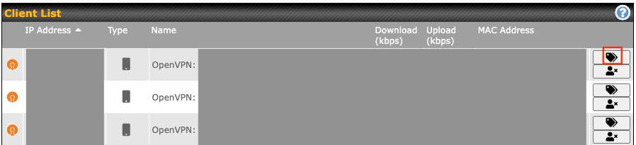

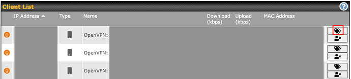

Similarly, when using OpenVPN, I would like to add DHCP Reservations for users to get the same IP upon each connection. It is supposed to function the same way as the “Ban” where you add the reservation and the reserved MAC ADDYS appear in the Network section of that LAN like so:
This worked, though my illustration was taken AFTER I removed the reservation I tested so the fields have no values. But even when there was a username, MAC Address, and Static IP, the user then disconnected, and connected again but was leased a completely different IP and the MAC Address did not match.
So while both Ban and Reserve would be great if they worked, I am not seeing any evidence that the DHCP Reservation is functional at this point - unless I am missing something!
