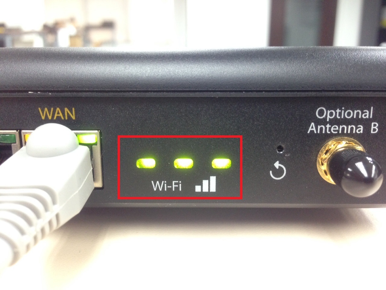

Hi Michael,
I’m referring to the WIFI Signal Strength LED indicators as attached.
Basically the “WIFI Signal Strength LED” indicated the connected “WIFI WAN” signal level. If the WIFI WAN for the Surf SOHO is connected, you will have the following solid LED indication:
Low - Solid 1 LED Light
Medium - Solid 2 LED Light
High - Solid 3 LED Light
Seem you don’t connect the WIFI WAN for the device, thus you will see the LED indicator are blinking randomly.
In firmware version 6.3.0, known issue reported that LED indicators, whereby the LED indicators still blinking although the WIFI WAN get connected. Targeted this will be fix in firmware 6.3.1
Thank You
We are indeed talking about the same thing, thanks for the picture.
That the lights blink randomly (its not really random, I did find a pattern) when not using WiFi as WAN needs to be documented. In fact, the bigger issue, that these lights ONLY apply to WiFi as WAN should be emphasized.
Thank you for your assistance.
Thanks for the heads up Michael, we have updated the manual.
