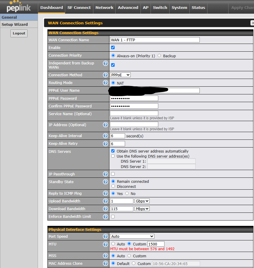

+1 for this, a lot of UK ISPs support “baby” jumbo frames as PPPoE takes the MTU down to 1492, baby jumbo frames allows PPPoE whilst still keeping the MTU at a full 1500: MTU - AAISP Support Site

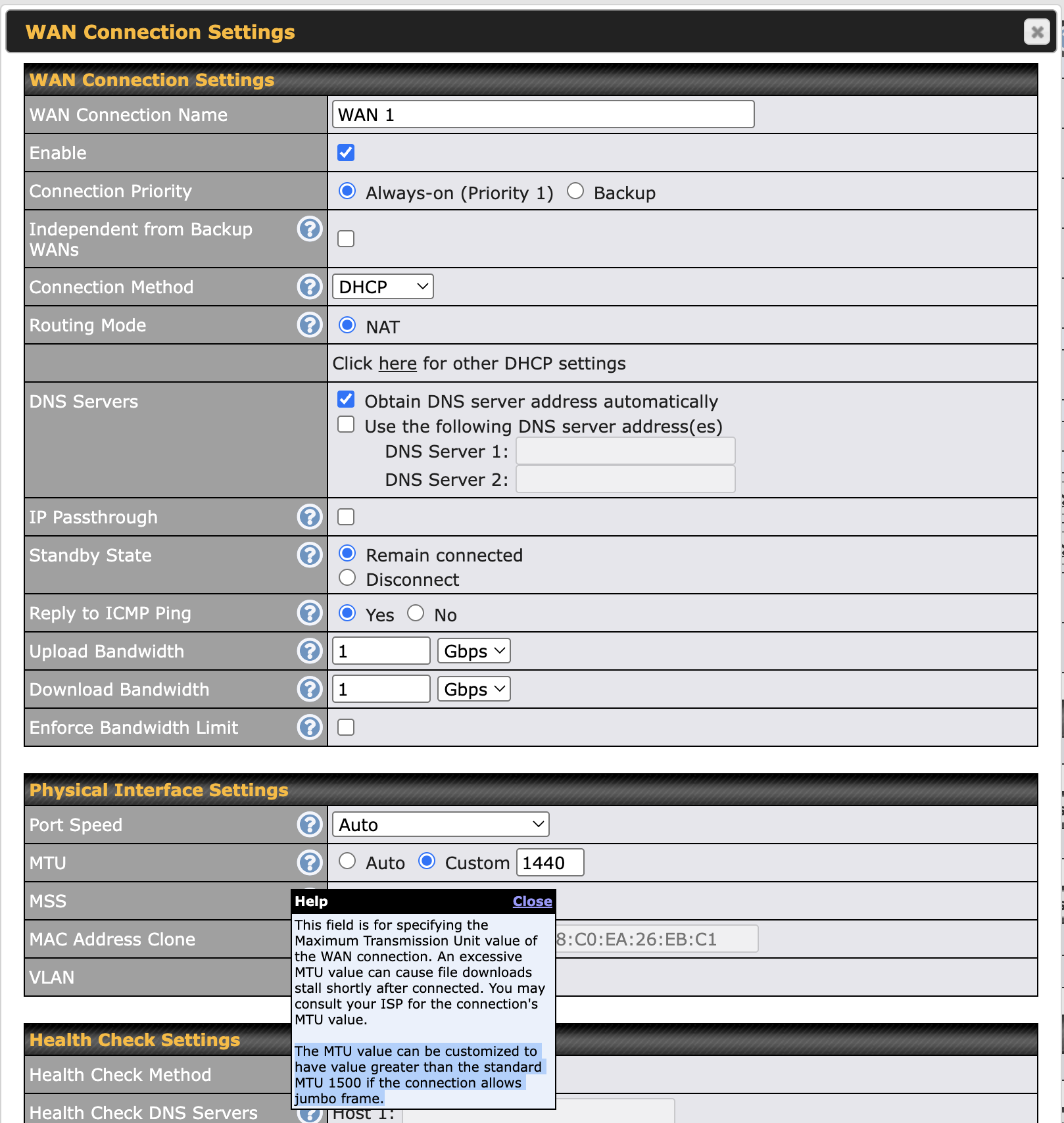

This is already supported.
“MTU must be between 576 and 1500”
Is the error message displayed when one tries to set the MTU over 1500. Can you please show that with an MTU saved above 1500. I cannot.
What firmware and router do you have. I suspect it is old.
I can confirm on 8.6.0 rc3 I can set MTU above 1500.
I cannot set the MTU over 1492 when using PPPoE as per my original post. I am using 8.6.0 rc3 and a Balance 310 (new 2026 version)
Got it - this only happens when using PPPoE. I’ve asked engineering to comment.

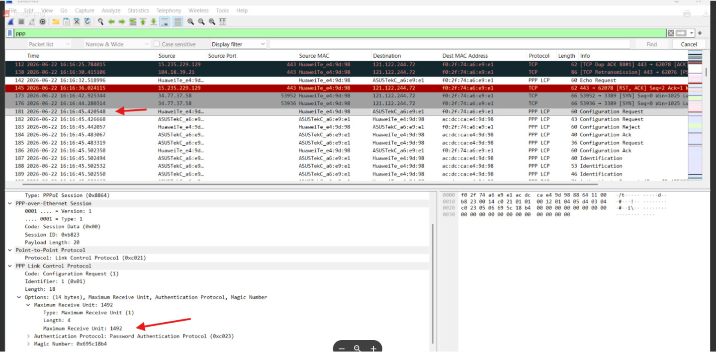

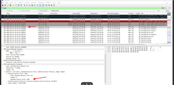

This is a very interesting request, and I would really like to understand the MRU size advertised by the PPPoE network.
So far, I have not come across an example of a PPPoE network advertising an MRU of 1500. If you are able to share the packet capture with us, it would be very helpful and would give us a valuable reference for this scenario.
You can use the packet capture tools and capture the MRU advertised by the network as the example below :
Both endpoints will send their own PPP LCP Configure-Request packets, and each request may include an MRU value.
Therefore, the packet capture should show the MRU advertised by both sides of the PPPoE connection. This will help us confirm whether the PPPoE network side is actually advertising an MRU of 1500, and whether the client side is accepting or negotiating a different value.
Please allow me to clarify.
For current Peplink devices, when using a PPPoE WAN connection with the MTU setting configured as Auto , the PPPoE client will typically negotiate and accept an MRU of 1492 . At the physical Ethernet layer, the interface continues to operate with a frame size of 1500 bytes .
Therefore, there is no need to manually configure the physical Ethernet MTU size, as the default 1500-byte Ethernet frame size is sufficient for standard PPPoE operation with an MRU of 1492.

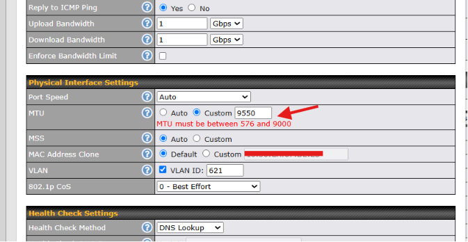

This question is about setting the MTU of an Ethernet interface above 1500. This operation is currently prohibited by the Peplink NOS. This is supported on pretty much any modern NOS.
Travis, this question has nothing to do with PPPoE.
This thread is about setting the MTU on an Ethernet interface to 1500. Is that going to be supported or is Peplink refusing to support that configuration.

  1. Ethernet WAN to be able to support MTU larger than 1500 (This is referring to Jumbo Frame support)
  • Device model which support Jumbo Frame for WAN will allow to configure the MTU up to 9000.

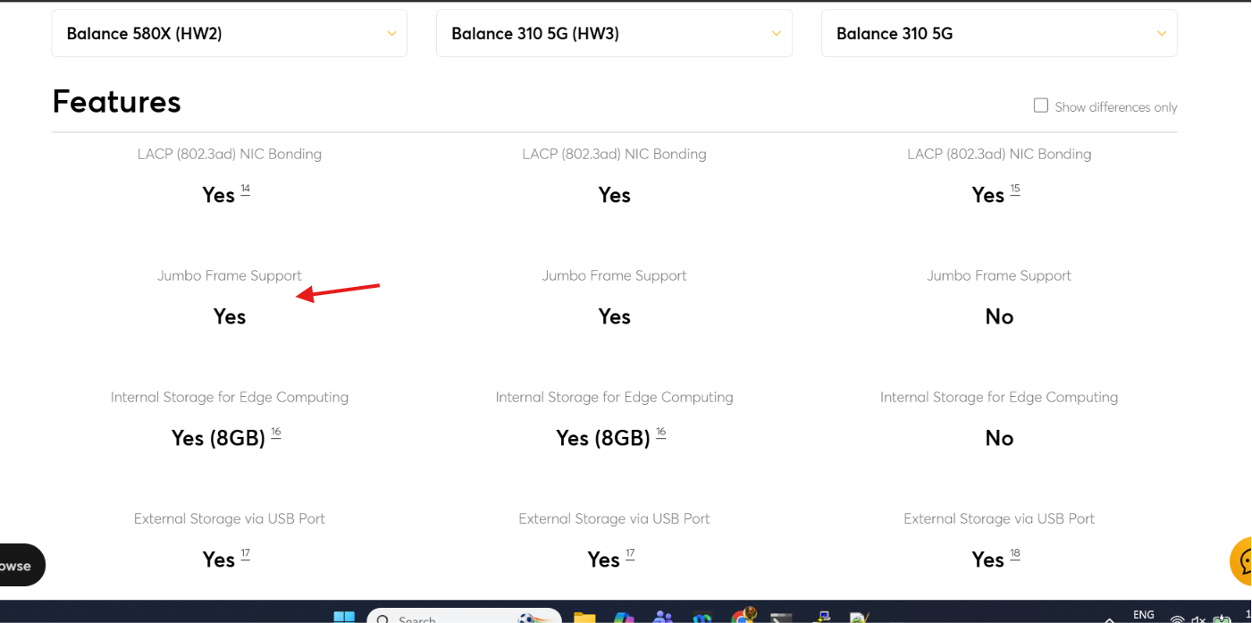

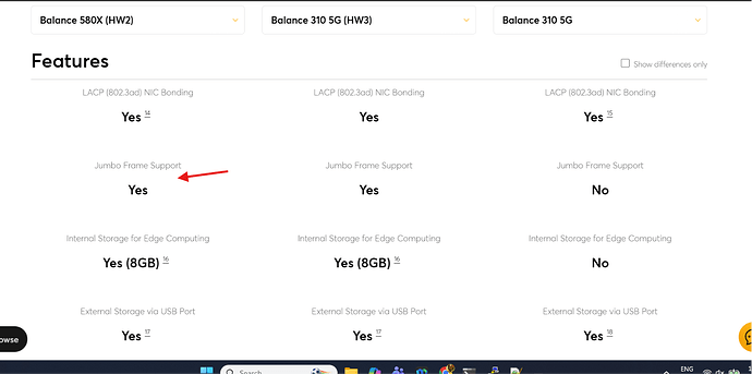

What models support jumbo frames for Ethernet. The Balance 580X does not.
I could not care less about PPPoE.
And why is this information not available on the data sheets. I would say your documentation, but as a vendor you have chosen to not document your product.
@Dan_Costello ,
Firmware 8.6.0 includes improvements related to jumbo frame support .
Could you please upgrade your device to firmware 8.6.0 and verify whether the issue still occurs?
For information on which models support Jumbo Frames , please refer to the Peplink Router Comparison Tool . It provides the supported features and specifications for each router model.
