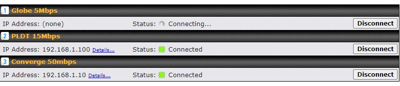

Now from Modem I’ve connected it to Peplink Balance 30. Referring on the attached photo, I couldn’t understand where the “IP ADRESS” will come from since ip and gateway of modem is the same.

Hello Sir Martin, thanks for your response. I’ve also tried changing from static to DHCP but it takes too long connecting. I haven’t seen it being connected, it’s just loading. I’ve tried other routers like dlink, tp link as alternative to Peplink using also the LAN1 of Globe modem and it works.
Strange. Sounds like its not negotiating port speed correctly on the WAN.

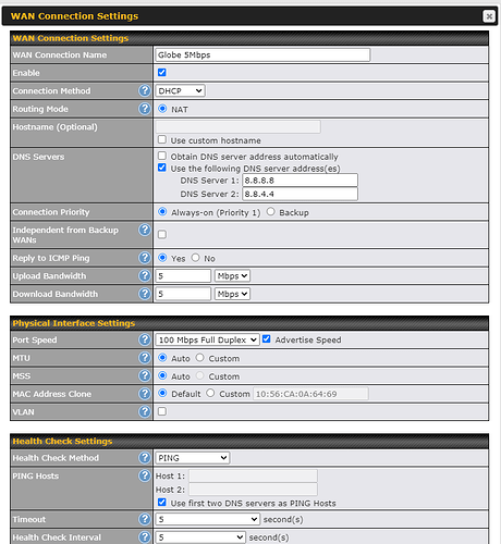

Edit the WAN settings and manually select 100 Mbps Full Duplex under Physical Interface Settings:

Are these the same type of DNS settings you are using for your other 2 WAN connections?
Have you tried changing the DNS settings around?
DNS Server - Check “Obtain DNS server address automatically.” Remove the check box for the manual DNS servers.
Under Health Check Settings → Ping Hosts → Put in the DNS servers you want to ping, ie: 8.8.8.8 and 8.8.4.4
Until the connection is actually up and working, you might want to disable to health check until that time.
You can probably try changing the port speed around at that point.
And last but not least, try powering down both the Globe device, and the Peplink device. Then power on the Globe device first and wait until it fully boots up, and then power on the Peplink device.
Also, upgrade to the latest firmware, if necessary.
