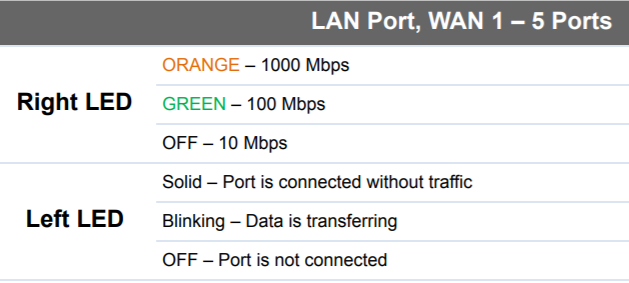

Good Morning, I was wondering about my Peplink Balance 580 there are port 4 used
What is the meaning of the light indicated of my WAN1 and WAN2 becomes orange the light indicated blinking while WAN3 and WAN4 become orange and green light blinking.
Thank you so much for your favorable response on this matter.
Hi Ronald,
The colour is an indication for the speed.
The light is blinking when data is being transferred.

The latest hardware version of the Balance 580 supports 1.5Gbps throughput.
I can’t say what speeds you should be able to get because the actual performance can vary across different networking environments.
