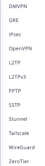

Well…
I build a not so clean solution… using another network vendor… and together with Peplink, I can support a lot of VPN protocols.
