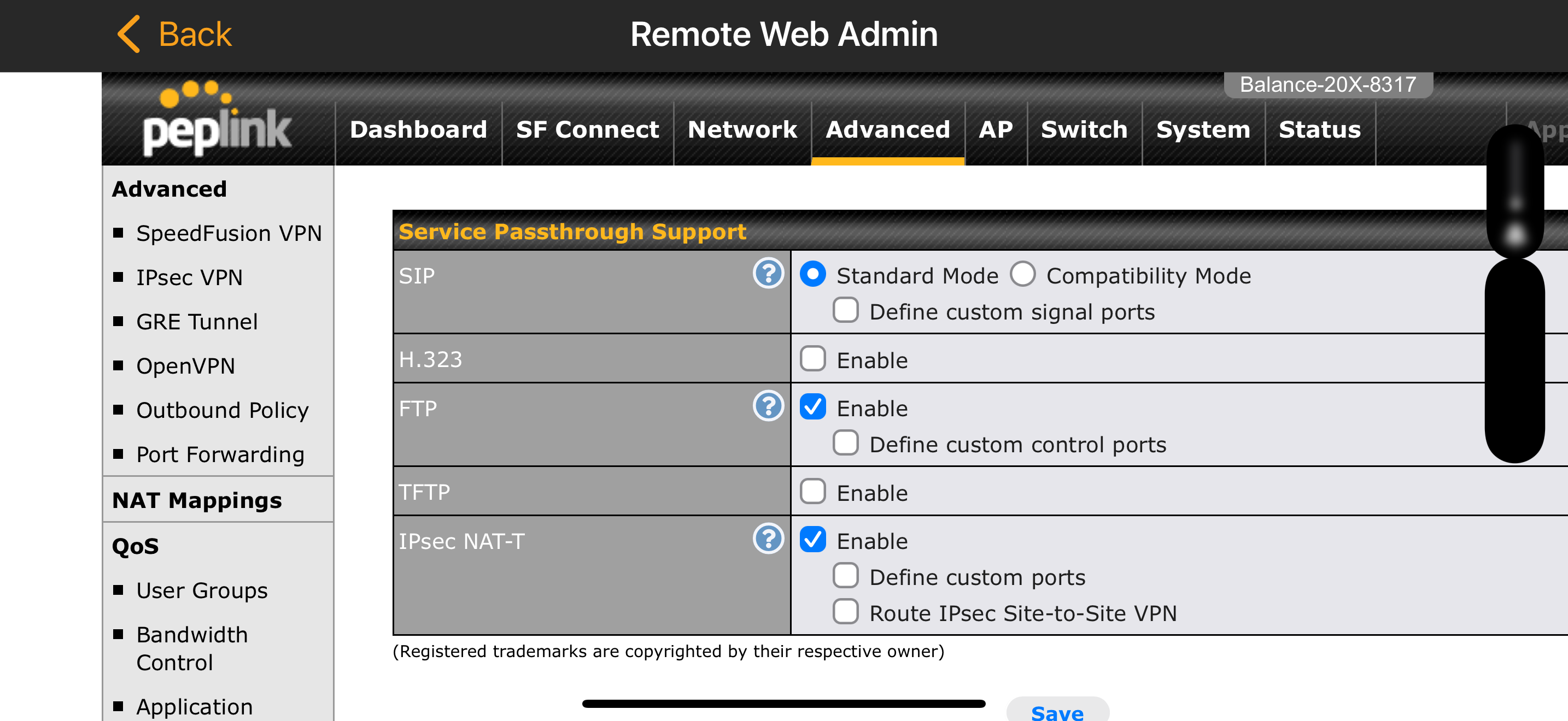

What onto have this setting set for SIP. Try changing it and trying again.
SIP ALG causes many issues with VoIP phones. Compatibility mode solves it
We tried Compatibility Mode, and quite a few custom port settings specific to Ooma…no change.
