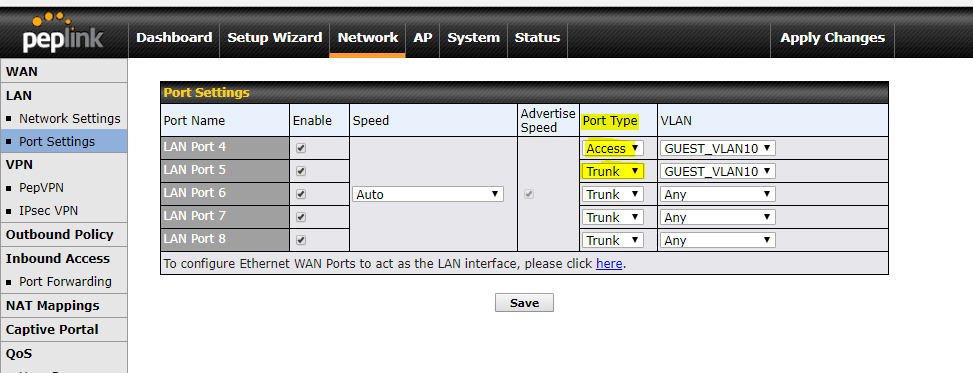

Since everything is running over the same port on the VM hardware, I am wondering if I could resolve the matter by creating a VLAN on my Peplink Balance One and use that for the virtual machine by assigning the VLAN IP address to the Windows 10 network adapter.
I gave it a brief try, but it failed to connect to the WAN.

Just to confirm the VLAN 10 defined for you VM Window 10 is “Access Port” or “Tag/Trunk port” ? Do you try before to define Balance One LAN port to “port access” or VLAN 10" to test on the connection ? If VM PC port is “access port” then Balance LAN port connected to the VM PC need to in “Port Type : Access”, else if VM PC port is tag/trunk then you need to make sure Balance LAN port connected to the VM PC is in “Port Type : Trunk”.
