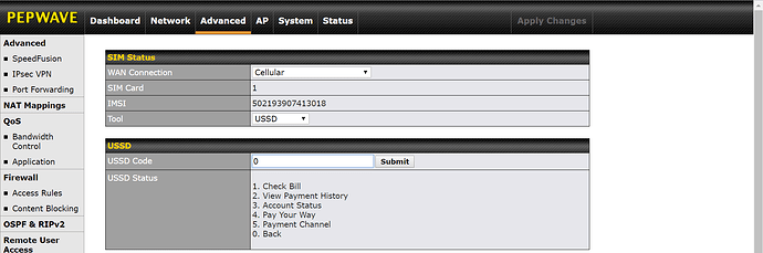

I have checked. The requested feature was supported. Please upgrade to this firmware - http://download.peplink.com/firmware/br1/fw-max_br1_br2-6.3.3s047-build2342.bin
Below is the screenshots I tested with this firmware.
  1. I purposely enter an invalid USSD code
  2. I enter a valid USSD code
  3. I choose 1
  4. I choose 0
  5. Back to the main menu as expected

Thing is that I never saw a menu actually appearing while using USSD. Is it possible that the feature was broken or not implemented on HD4 with firmware 7?
Thanks!
Would you able to screenshot the USSD page and share here ?

Just to check the #225# is a valid code ? and it suppose to return what service option ?
Would you please open a support ticket for support team to check ?
The exact same code works now and I can even do chained commands #225#XXX
I have forced the modem on one sim, maybe it helped.
When you click on the submit button for the USSD code, it will send out via the active SIM. Base on the screenshots given, the SIM cards IMSI info are different, suspect that the same USSD code is invalid for SIM card IMSI ended with 4384. Would you please confirm ?
Good to heard that it wok for you now :+1::+1::+1:
all ok, it is the same provider but on card level issue then.
