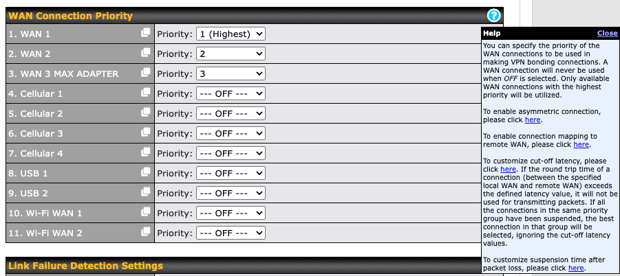

Have you tried with an asymmetric connection in your Speed Fusion Profile with Bonding? Set one of the WAN’s on up/down and the others on upload.
You can find the setting here in your Speed Fusion Profile: (First click here behind the questionmark).

Thanks for responding. That is properly set up. There might be other settings I should look into… Thank you!
