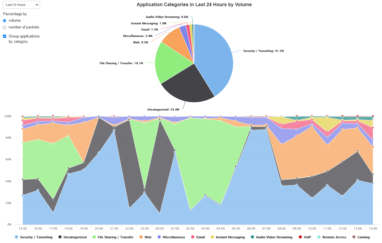

With Deep Packet Inspection reports, you can now have a clear classification of the traffic type that passes through your router, how big a percentage of the bandwidth they occupy and during what time.
For example, in the above pie chart, you can identify that “HTML5 video” accounts for 20.8% of the total bandwidth used.

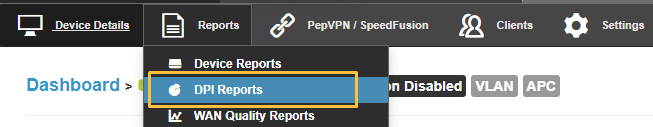

To access the DPI Reports on InControl 2, navigate to device level in your organization:
Mouse over Reports, then click on DPI Reports.

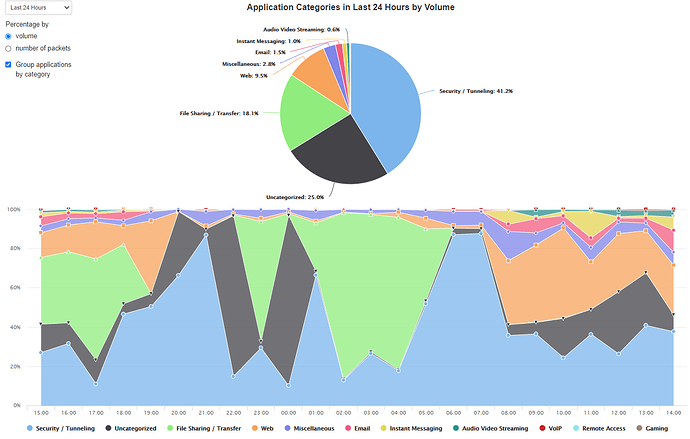

The DPI report on InControl2 will show deeper information by breaking down the application categories (e.g. File Sharing / Transfer Applications) into sub-categories (e.g. iCloud, OneDrive, Google Drive).
By default, the DPI report is showing the graph based on application categories by percentage volume traffic.

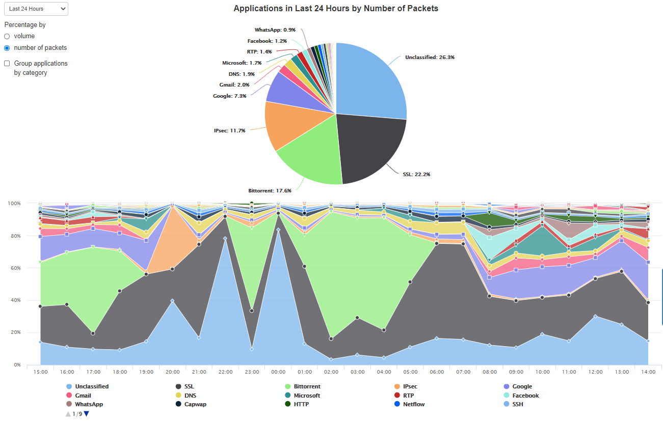

The report can also show the graph based on applications by the number of packets, so depending on the perspective you are trying to look at.
