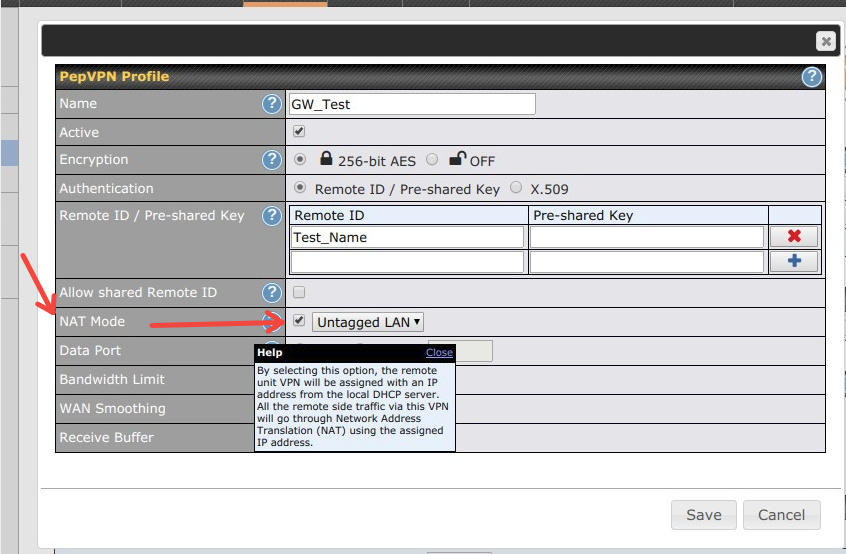

In the PepVPN profile you can turn NAT Mode off by unchecking the tick box.
Odd, as you’re defining your PepVPN connection via InControl.
The default configuration during PepVPN setup is with NAT disabled. Could you please re-check your config?
If your config is correct and you’re still seeing NAT behaviour out of your fusionhub, please open a support ticket.
NAT is not enabled in the config. I will open a support ticket. Thank you.
