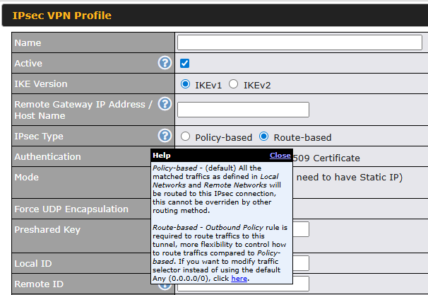

Have you tried changing the IPSec type to Route-based? Then you can use outbound policy rules to send whatever traffic you want across the tunnel.

Yes, I’ve tried changing to route based and added an outbound policy for source network to destination network, encforced / IPsec tunnel. IPsec tunnel still up showing a green box and 10.100.1.0/24 ↔ 10.10.0.0/16.

Switched to Route-Based and added an outbound policy enforcing all traffic through the VPN as suggested by another PepLink engineer. Still no change.
