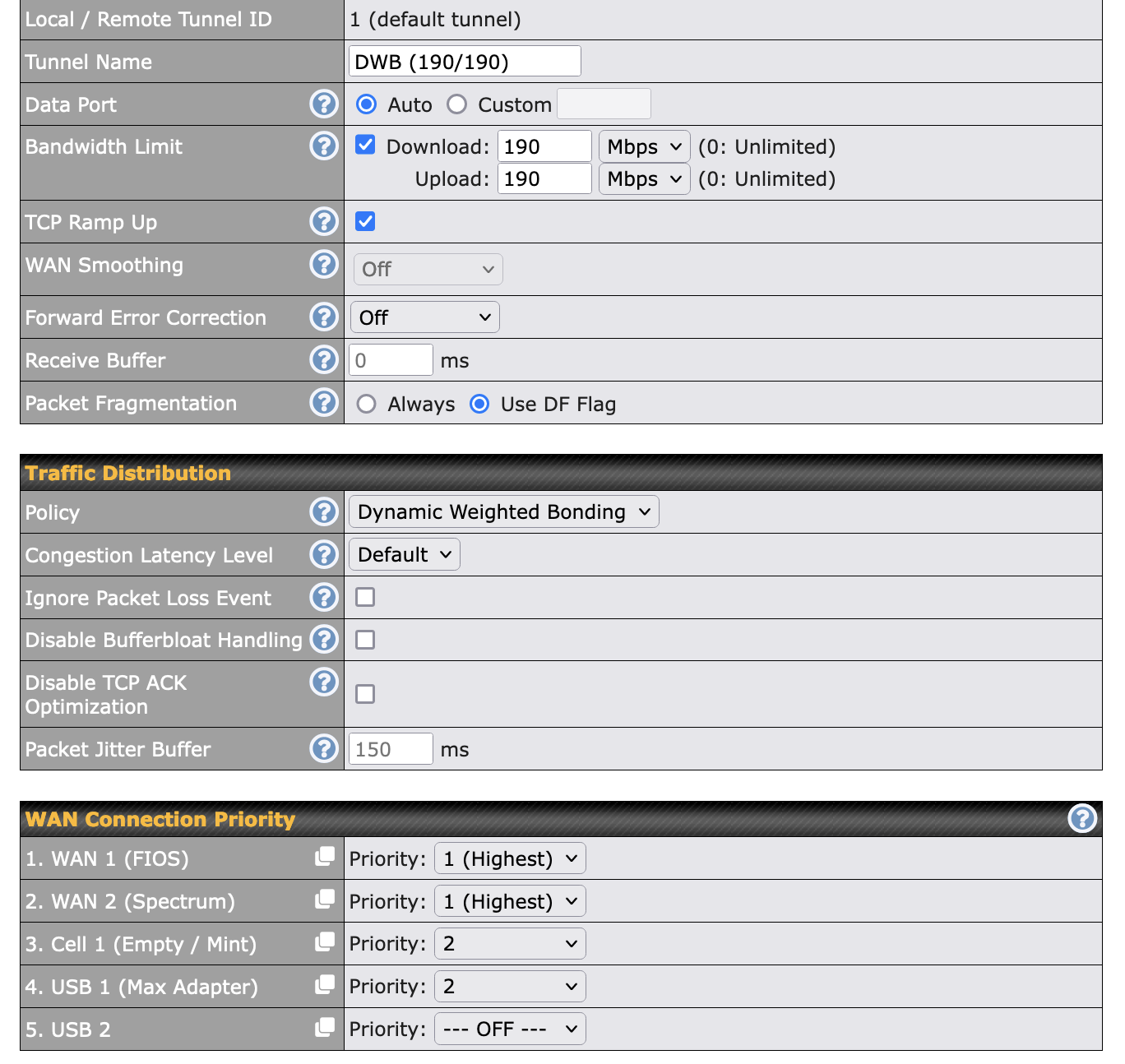

FWIW, you have a lot of WANs active for WAN Smoothing in my experience. Do you need all of those? I’ve found that its better to pick the connections that I want to use as my primary (and lower cost) bandwidth. The overall redundancy level of Medium also uses more bandwidth in my experience. I’d recommend setting DF and using Bonding rather than DWB. I’ve also found that setting bandwidth limits helps avoid packet loss if something else is using the WAN Smoothing connection. Also, in my experience FEC doesn’t help real-time 2-way video traffic.

I’d also suggest trying using DWB, without WAN smoothing. It does a great job for me.

Sorry to hear that those recommendations didn’t improve it for you. I use those settings with a few minor tweaks on multiple Transit Duos and they work great.
DF is do not fragment. It is in the Packet Fragmentation area.
Have you turned off Forward Error Correction as that affects timing?
I have experienced varying problems with Starlink recently especially with latency and poor upload in congested areas. What happens if you try this DWB setup with the bandwidth limits? If you still have problems it would point to your Starlink as a problem. As a trouble shooting step, unplug your Starlink ethernet from the Duo. It’ll instantly drop to the cell connections. What happens then to your performance? The screenshot is from a Transit Duo deployed in the middle of nowhere and reliably streams Zoom, Webex and Teams with Starlink and we can only get 2 bars of Verizon LTE (no AT&T or T-Mobile).
