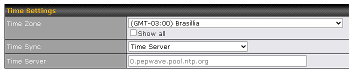

hi, @WTurner
Is this device, with the last Peplink OS?
Model: Pepwave MAX BR1 Mini
Firmware: 8.3.0 build 5256
