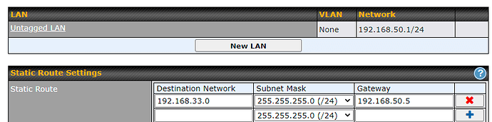

Did you add the static route to the BR1 of 192.168.33.0/24 → 192.168.50.5 ?
Yes,
this is my BR1:
This is my Soho

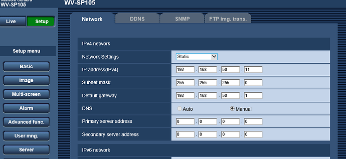

Does camera have a default gateway set to 192.168.50.1?

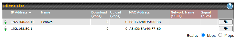

This is the client list from Soho (PC and BR1), no camera

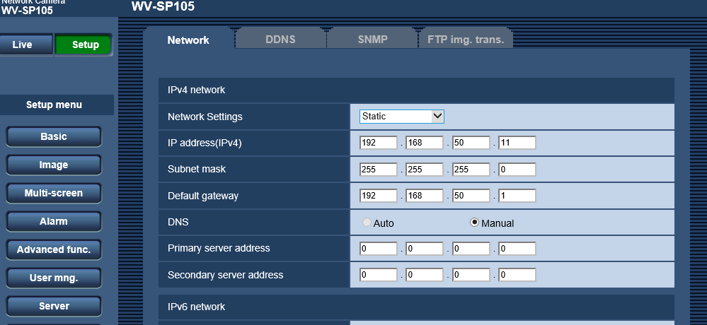

Double check the camera’s network settings. Most likely reason is that the camera does not have a default gateway set.
These are the cctv settings:

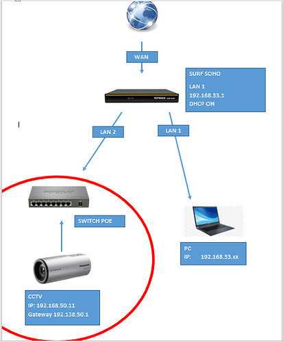

I try to ask another solution.
In the next situation, I can’t manage devices in red circle.
There is a device who give dhcp to camera but I can’t manage it.
I know that the camera has IP 192.168.50.11.
Is it possible to see the camera from PC?
I can setting something into Surf Soho to permit to the pc 192.168.33.xx to see camera 192.168.50.11?
Thank you so much Martin, really
Is the 192.168.50.1 IP the camera has as the gateway the SOHO LAN 2 IP?
If so then this should work fine.
With LAN2 Ip gateway camera works in this solution.
Martin really thank you for your support.
