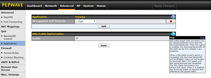

You may want to look into the DSL/Cable Optimization feature. If its on turn it off and vice versa. See

Thanks, I’ll try disabling the DSL/Cable Optimization feature.
