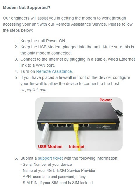

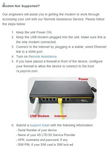

Hello,
If the modem is not apart of our 3G/4G compatibility list we may be able to create drivers for any unsupported modems.
Hi Jarid,
Thank you for the information. I have confidence in PepLink that an support ticket will solve the compatibility issue with one specific model.
However, in the initial plan, I will deploy the Surf SOHO in our office in 50+ countries. We will purchase the USB modems in the local market. Many offices are in Africa, therefore there is a big chance that I don’t find a suitable modem (especially LTE USB modem) in the compatibility list. In such case, I want to give a guideline to the local office on how to find a USB modem that MAY work in “auto” mode. Do you have any suggestion? Is there any particular feature in the modem I should look for to make “auto” work?

The auto functionality isn’t specifically for unsupported modems. It is used to grab APN/Dial Number and authentication information when the cellular SIM initiates a connection request to the cellular provider. In some cases, cellular providers will have custom information that needs to be defined, which can be done by using “Custom Operator Settings”. The Firmware on the SOHO is actually the determining factor whether or not it will talk to the USB modem properly.
