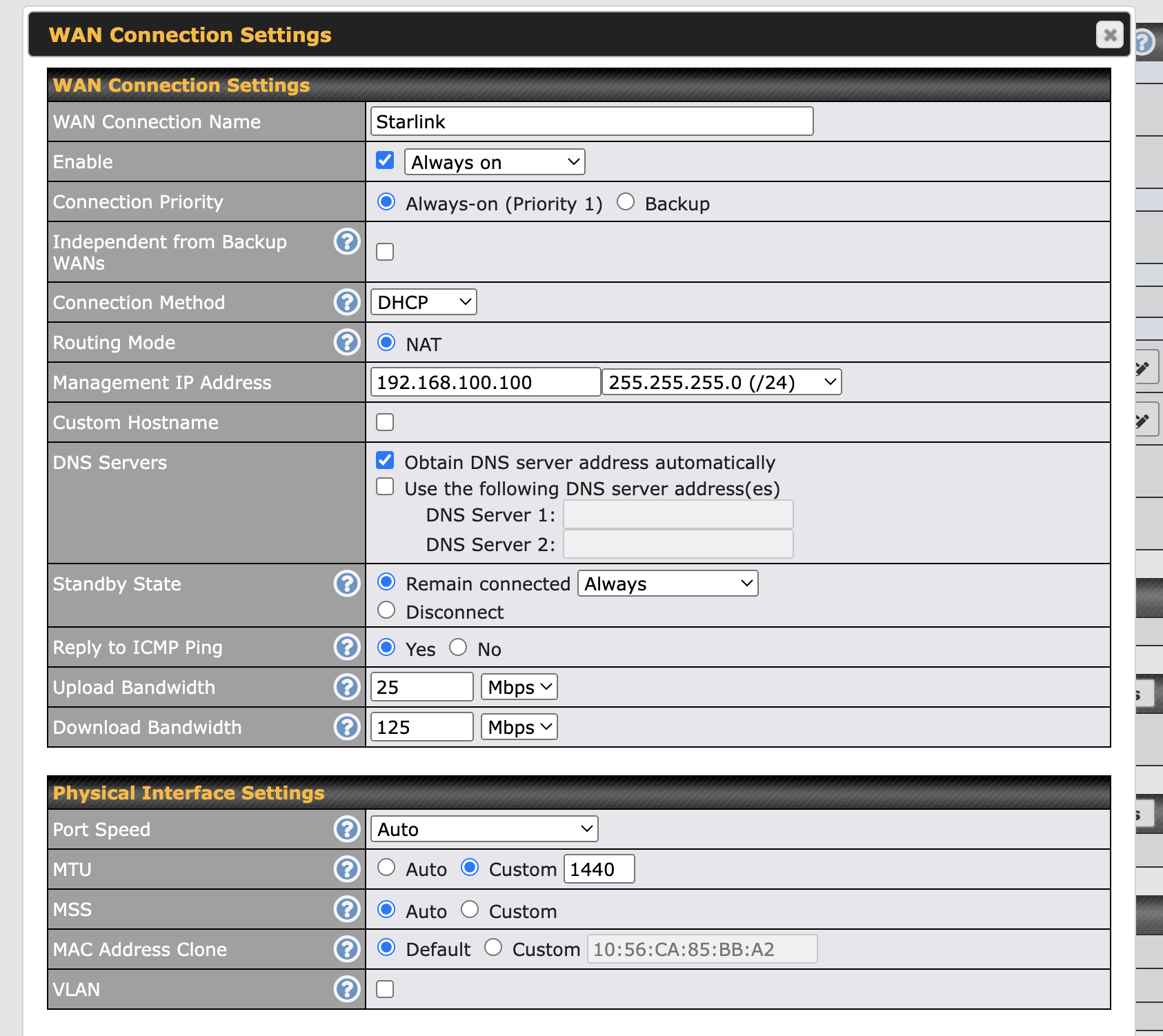

I have a Starlink on my boat connected through Peplink to provide a wireless network. The Starlinks personal wifi is off, so it goes through the Peplink to create a network.
My question, which I hope you all can give some insight into, is why I am having Health Check issues. Pictures are below to indicate my settings. I only solution I have found is to disable Health Check completely, but I would prefer to have a Health Check involved. I have tried changing to a PING, DNS, and HTTP. I currently run it on HTTP. I am not sure if the rain is a factor, but every time it rains, I get a Health Check failure. I’m sure it’s more than that since it also happens when it is not raining. Any help would be greatly appreciated.

For the second URL check you will need to look for matching string “NeverSSL” instead of current “success”.

I will change that now. Thanks
