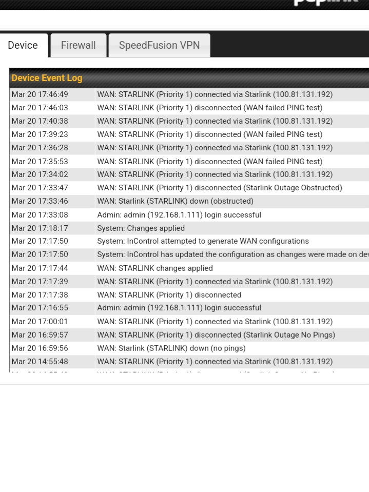

Having continual issues keeping starlink connected to Peplink Balance 310 HW4
Have setup with guides in forum so that it can continue to use its supplied router and allow access to software control panel for starlink.
Connection drops regularly, every minute basically, have tried DNS and PING type healthchecks using 8.8.8.8 and 1.1.1.1
Have tried googling issue and have had a look at other posts and most seemed to suggest trying a ping instead, which i have done.
I could be setting it up wrong, i am no expect, screenshot attached.
I have no idea why its doing this, when using starlink directly over wifi through its supplied router starlink is holding connection well with good download etc 150mbit plus and 15 down, all seems to work.
Have resorted to just disabling healthcheck at the moment, and it works fine but obviously cannot detect if Starlink service is actually down or not.
Using speedfusion with a 4G sim, but i do not know that this is that relevant as it seems the issue revolves around the peplink box thinking starlink is down when it is not.

Have tried this today (switch between starlink router and peplink) and unfortunately the issue is identical, still WAN failed PING test, tried DNS type too.
I believe starlink is actually fine and the issue is this heath check not working correctly with starlink.
Failing every minute basically. I have it set to timeout 5 seconds, health check interval 5 seconds, retries 3, recovery retries 3.
Not experiencing starlink drops using it directly over wifi without the peplink.
If i disable the heath check it all seems fine and in a sense better because the Peplink is not avoiding the starlink connection after deciding incorrectly that its down.

I have left the health check off, and i am running two wan (Starlink and EE 4G) through speedfusion setup, if starlink was actually down in real life, should this setup keep us connected?
Its not ideal to tell the peplink box that this starlink wan is good with no checks to make sure it is running.
