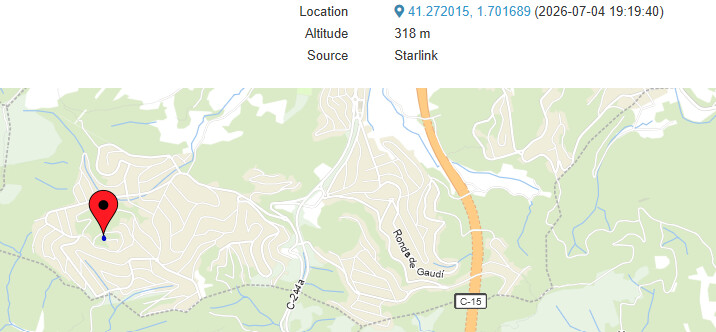

Still persist after a reboot. Now there is the Starlink position map in router dashboard too. But forward still didn’t work like our routers with internal GPS.
