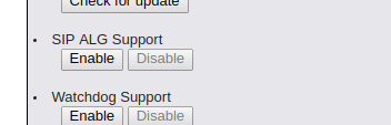

All I want to do is confirm what I read. Does Standard Mode turn off SIP ALG or to disable it, do I need to set it to Compatibility Mode. The setting under Network>Misc Settings>Service Passthrough>SIP
Hello jjordon,
Standard Mode > SIP ALG is Enabled
Compatibility Mode > SIP ALG is Disabled
You can also navigate to the support.cgi page. Change the IP address in the address bar from <IP_ADDRESS>/cgi-bin/MANGA/index.cgi to <IP_ADDRESS>/cgi-bin/MANGA/support.cgi. You can changed the SIP ALG Support here as well.
