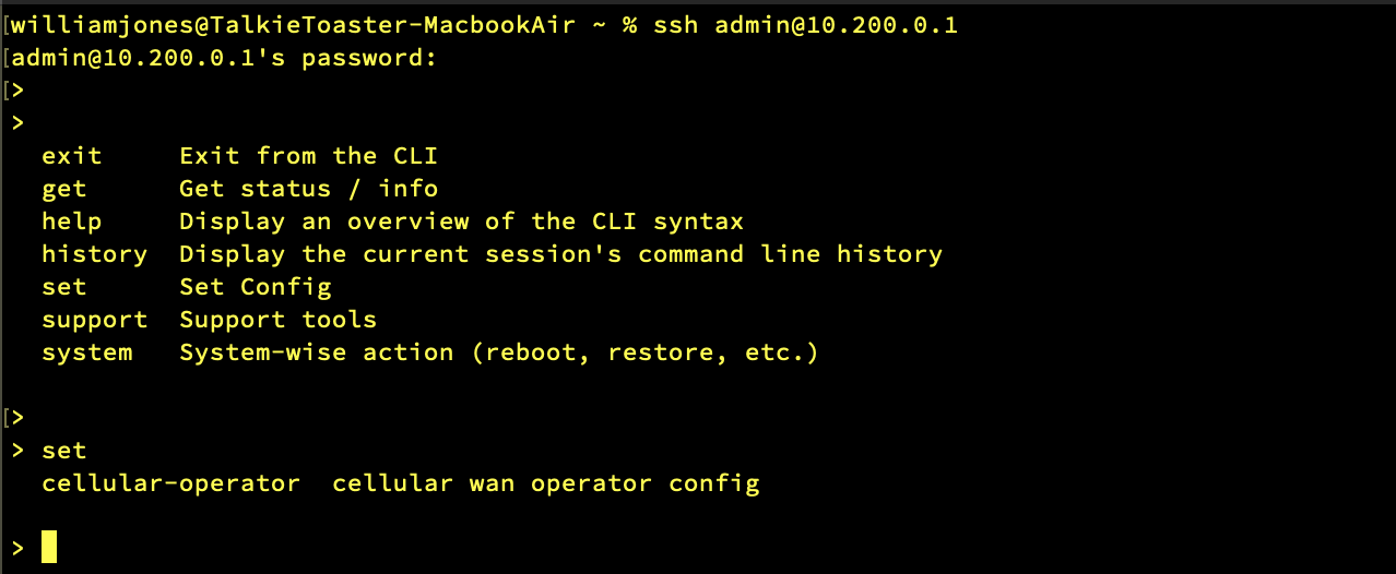

So I managed to SSH into my router.
But I am unable to run iptables command as illustrated here
Spaces / Blank characters are not being accepted.

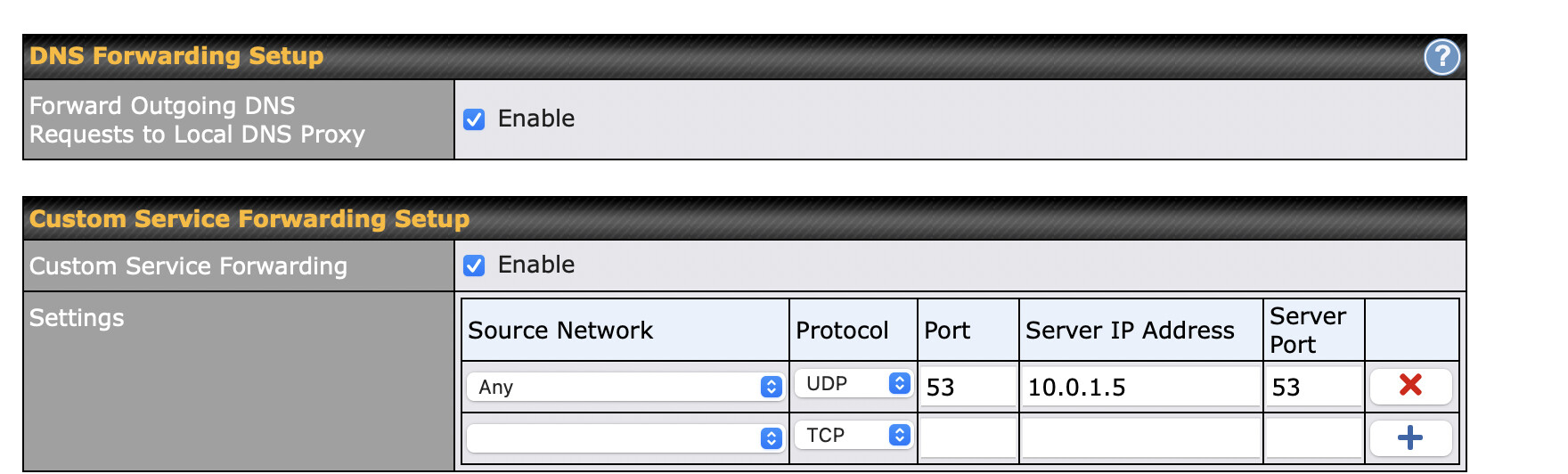

You don’t need the CLI for this.
Navigate to Network > Service Forwarding.
Turn on DNS forwarding and then add a custom rule for DNS over UDP underneath setting the server IP to your pi hole or to the LAN of the Peplink if you don’t have pihole…
Then all standard DNS queries will be forced via the Peplink (which acts as a DNS proxy) and then you can decide where you forward them from there.
That’s because it’s not going to give you the ability to do what you want, the CLI on the Peplinks is pretty limited to some basic debug commands and some show commands to give you a bit of system info and PepVPN info.
It makes no difference if you access it via SSH or the WebCLI function of Ic2, it’s the same interface you are dropped into.

Peplink has a feature for this.
Under Network > Service Forwarding look at the DNS forwarding option.
This will effectively have the Peplink intercept all outgoing DNS from clients that are using standard UDP/TCP 53 for DNS and send the queries to the internal DNS proxy and you can then decide where to forward them onto.

So I did that and I did a test by manually changing the DNS on my iPhone to Google’s DNS.
The internet did not work at all.
Let me give you some more details regarding my setup.
I have a Raspberry Pi running Adguard on 10.0.1.5
I have pointed the DNS server in Untagged Lan to it.
I enabled the above as you said,
But as I said above when I manually changed the DNS on my iPhone it did not work, I would think that even if the user changes the DNS the internet would still work but be forced through the specified DNS right? (that’s what IP Tables was for right?)

I am using my iPhone X, setting the DNS to Manual and removing my DNS server 10.0.1.5 and setting to 8.8.8.8 to simulate if a person is changing it.
I have set the Custom Forwarding like shown
But I am unable to load google.com or 1.1.1.1/help or any site for that matter.
It says “No internet connection” in the Wifi Settings
Oddly though apps like Instagram and Facebook do work and refresh content, but not all apps.

You need to enable DNS proxy - that’s where the requests are being redirected to

I added this entry as well with no other settings and that seemed to do the trick.
And I can verify if I manually override the DNS on my iPhone or Mac it doesn’t work which is great.
