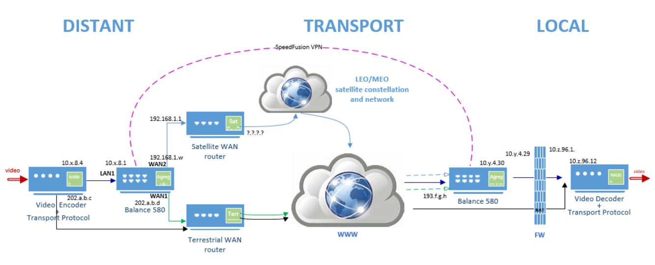

Hereunder is a sketch of the architecture:
  • in blue/green the stream I am trying to create
  • in black the main stream that does not use Peplink.
  • I have considered that the VPN is between the two Peplinks private addresses 10.x.8.1 and 10.y.4.30 and declared the routes according.
  • Are there any firewall settings in the Balance580 that I could have missed?
  • I found in another post here that it is advised to set the WAN routing parameter to ‘IP forwarding’ instead of ‘NAT’. Done. To no avail.
What could be wrong? What could be missing?
This project is my first encounter with Peplink so I have much to learn for sure.
On the other hand, this is a POC to implement this kind of architecture on more sites worldwide, so I want to have everything clear.
Thank you all!
Isa

And what is your architecture? Do you have any drawing?

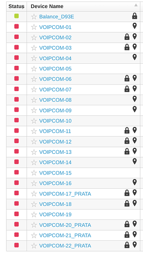

Balance is the at the LOCAL (datacenter)…
All the other 22 peplink are in remote locations.
Each case have a Peplink device and antennas to improve LTE signal.
Inside of truck, there is a network switch and they connect what they want, to stabilise the streaming service.

Assuming you did not enable NAT on the VPN profile (as it seems you can ping end to end that is unlikely - but to be clear you mean that a device in the same subnet as the video encoder can ping a device in the same subnet as the decoder directly?) then I’d be looking at that “firewall” you’ve drawn in your diagram as where to begin.
If you were to move the video decoder infront of that firewall, i.e. directly attached to the Peplink does it work as expected?

It is not possible to bypass the firewall, even for tests. The security team would report me to the police :wink:. I tried streaming to another decoder which is not behind the same firewall. It worked but it’s useless as i’m not using the SpeedFusion VPN either…
What could be missing in the firewall rules?
At a guess they’re dropping the ports you require for the protocols you want to use, they might also depending on the firewall they are using be doing more sophisticated application inspection / protocol inspection to determine what to let through.
It sounds like a sensible way to approach this might be to gather the required source/destination IPs and ports and work with your firewall and security people to permit the required traffic, but if you want to rule out the SpeedFusion and Peplink components you might need to gather some evidence that it is doing what you expect.
