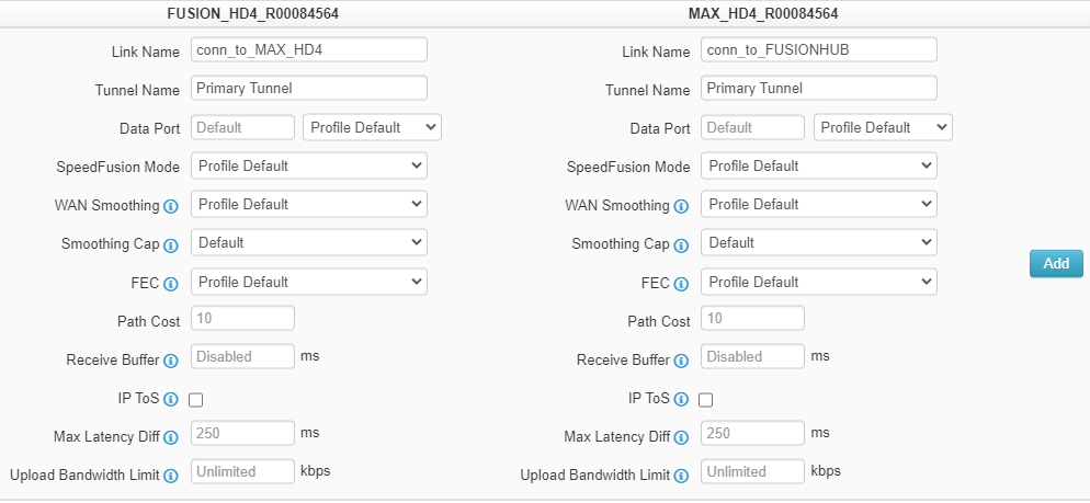

Thanks sitloongs that makes sense. One more question:
When configuring the tunnels I get the option to set things like WAN smoothing on the connection from my HD4 to the FusionHub and from my FusionHub to the HD4 - if I want to enable WAN Smoothing for example should I enable it on both directions or only from the HD4 to the Hub?
You should enable WAN Smoothing only if you encounter jitter with your video/audio streaming. WAN Smoothing is unidirectional. You may enable WAN Smoothing on FusionHub if you have a streaming issue from FusionHub to HD4.
