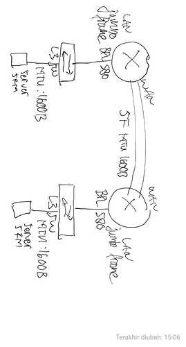

I have a case, the user wants to connect 2 vmware SRM in a different location using speedfusion
vmware requires MTU1600byte
can speedfusion and lan connections provide 1600 MTU
can peplink overcome this scenario
maybe someone here found the same case?
thankyou

Hi, This is a valid setup assuming you have all the prerequisites in place:
You need a combination of WANs that support Jumbo frames and have a combined MTU of 1680 or greater. You can read more on the WAN MTU combination specifics in this response from our Engineer, Kenny.
You need support for Jumbo frames and MTU larger than 1680 on all of your WAN side devices as well
Based on your diagram, it appears as though you have these items in place. If so, SpeedFusion will allow the 1600byte packets to be encapsulated with the addition of SpeedFusions 80 byte overhead.
I had configure WAN interface 1600MTU in BPL580, so bassicaly speedfusion MTU based on MTU in WAN interface?
i have check BPL 380 do not support larger than 1500MTU WAN interface, so BPL380 do not support 1600MTU and BPL 580 can support 1600MTU?
