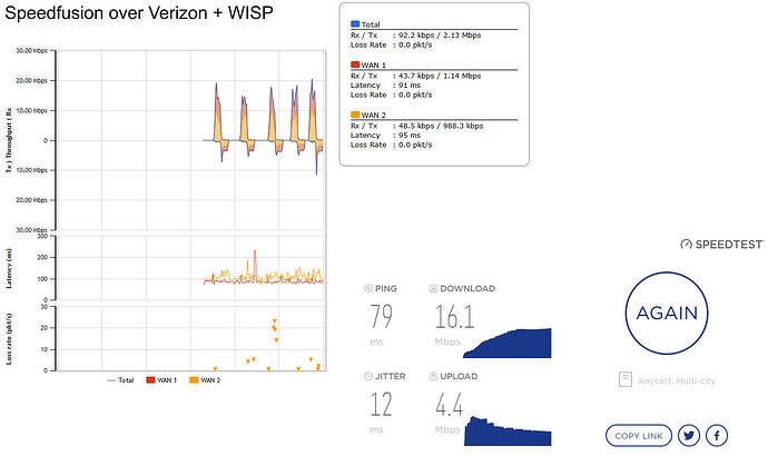

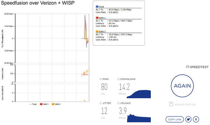

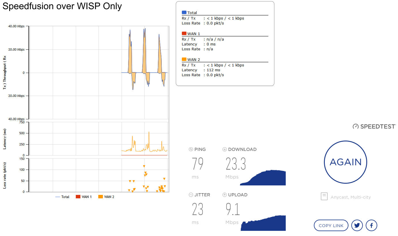

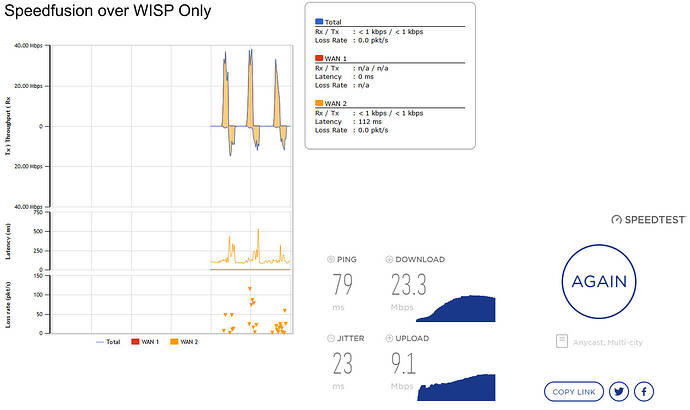

Interesting. Can you open the live speedfusion profile graph in a new window and run the tests again then post a screenshot of the graph for review please.
Thanks. Here is what I’m seeing right now:
Its the packet loss and jitter over the WISP connection that is screwing with your bandwidth when both WANs are active.
Because I’m lazy I would turn on forward error correction (in both directions) first and see if that helps.
Then if it wasn’t enough I would turn it off again and fine tune the suspension time after packet loss and cut-off latency values for the WISP connection which seems to be the trouble maker.
Start with a cut off latency of 130ms and a suspension time after packet loss of 100ms.

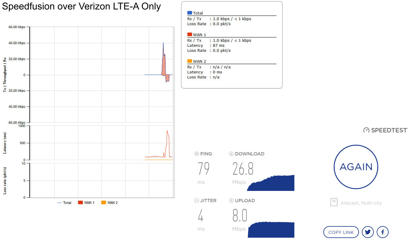

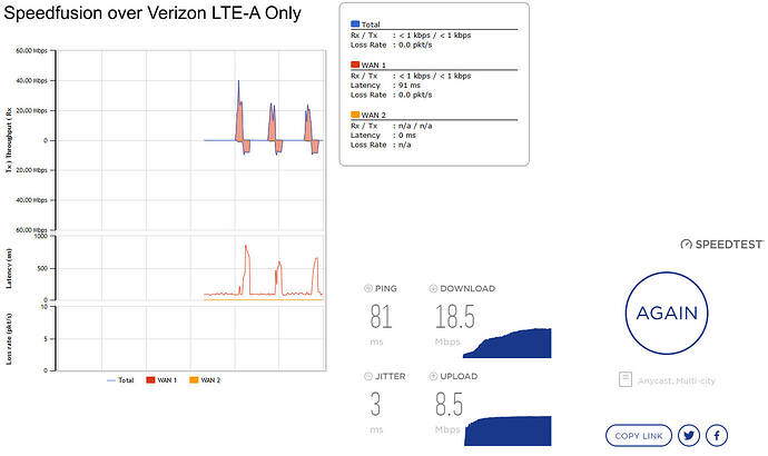

Now the verizon connection is getting a speedtest.net score of 29.6 mbps download speed, 14.09 mbps upload speed used without speedfusion, but over the speedfusion link I’m getting 1.10 mbps download speed, 12.34 mbps upload speed.
It’s as if speedfusion on the download side is being throttled only. I disabled FEC on both the balance and fusion hub, and then rebooted each for good measure even, but this condition remains and also seems to occur during both daytime and after 2:00 am (in case it was some kind of deprioritization affecting only the speedfusion port range). Very strange. I did the 8.0.0 to 8.0.1 firmware update during this timeframe too. Switching to an ATT sim the speedfusion speed is normal although ATT is performing a little slower here than verizon was previously. Not sure what is suddenly going on with speedfusion over the verizon link now.

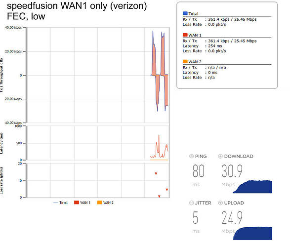

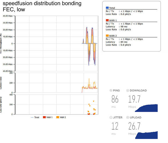

Enabling FEC, low on the upload helped a lot, and is better under these conditions, at least when testing today, than the latency/packet loss on wisp.
With FEC disabled on the upload (balance) side, at 2:30 am:
Verzion Alone: 24.4 mbps upload
Verizon + WISP: 11 mbps upload
With FEC enabled:
Verizon + WISP 27.1 mbps upload
With FEC disabled and cut off latency of 130ms and a suspension time after packet loss of 100ms enabled on wisp WAN2 only:
Verizon + WISP 15.9 mbps upload
However, on the download side, FEC didn’t seem to improve things, but not much worse tonight either; however I was not able to get a download speed greater with Verizon + WISP than with Verizon alone and WAN2 disconnected tonight.
For now I have FEC enabled on both the upload and download sides.

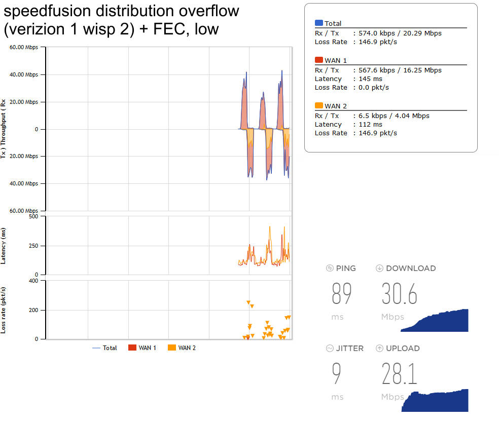

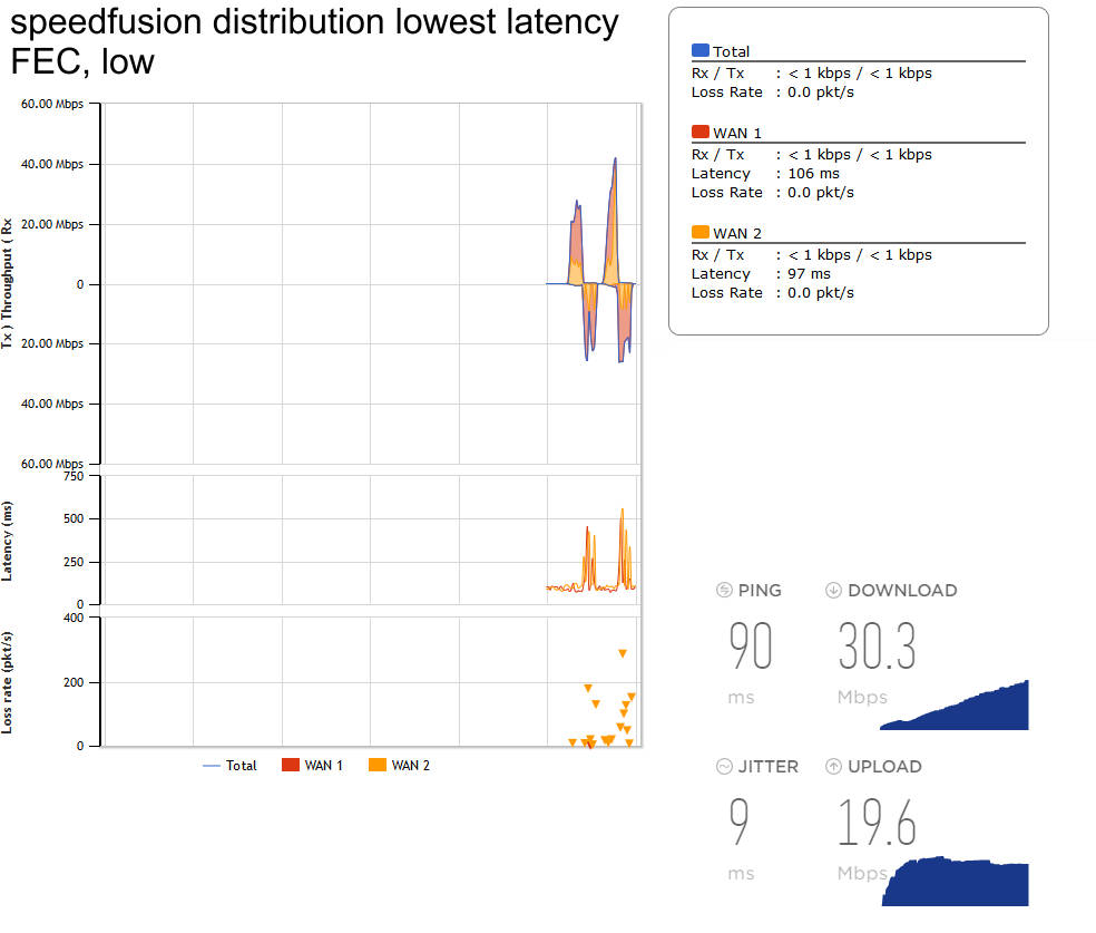

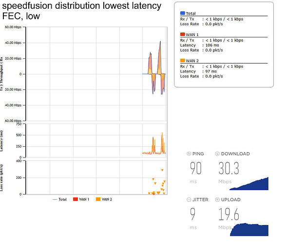

Trying now with speedfusion traffic distribution policy changed from Bonding to Lowest Latency.
Download speed with Verizon + WISP + FEC + Speedfusion traffic distribution: lowest latency: 35 mbps (in comparison download while traffic distribution: bonding with FEC, low yielded 20 mbps download tonight.)
Upload speed with Verizon + WISP + FEC + Speedfusion traffic distribution: lowest latency clocked 17 mbps upload. (bonding with FEC, low yielded 27mbps upload tonight.)
traffic distribution policy overflow + FEC
upload: 29.8
(with verizion as priority 1 and wisp as priority 1 overflow precedence 2)
Oddly overflow doing a speedtest downloads only over verizon but uploads over both connections. I’m not sure what would trigger the download side to “overflow” to wan2 that the speedtest doesn’t trigger.
I’m not sure if speed fusion traffic distribution: lowest latency will work for me here with the WISP connection having so much jitter…
High jitter is an affliction of many WISP systems, particularly those that are oversubscribed or have insufficient back-haul capability. So, not surprised. Sad but true.
Here is what it looks like (when both connections are individually at their best in terms of speed, in the early am hours.) This is with FEC enabled in both directions set to low, and no latency cutoff or packet loss cutoff set on either connection.
