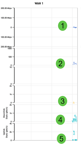

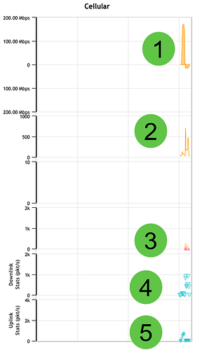

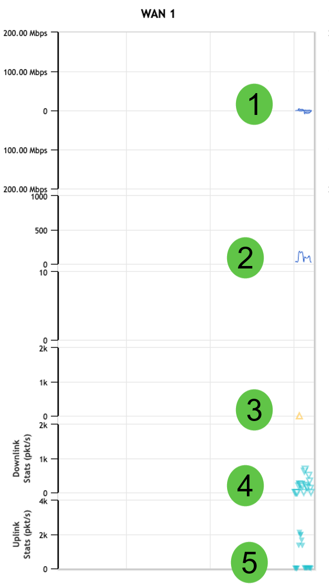

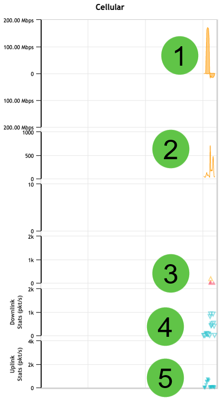

Sorry for the delayed response. Please see image attached. The Fortinet is plugged into WAN 1.
@MartinLangmaid does that screenshot help?
The images don’t show enough activity to help us arrive at root cause.
On the cellular WAN we can see that:
  1. as Cellular usage rises and saturates the link
  2. the latency rises also.
  3. and we get packetloss
  4. Which causes the Fusionhub to send duplicate packets (that we discard)
  5. And us to send duplicate wan smoothed packets back
On the Wired WANwe see:
  1. Much lower bandwidth levels
  2. What appears to be link saturation from a latency perspective
  3. the hint of out of order packets
  4. lots of discarded inbound packes
  5. tons of upload packet duplication - which is weird as this is normally triggered by packet loss which we don’t see here.
