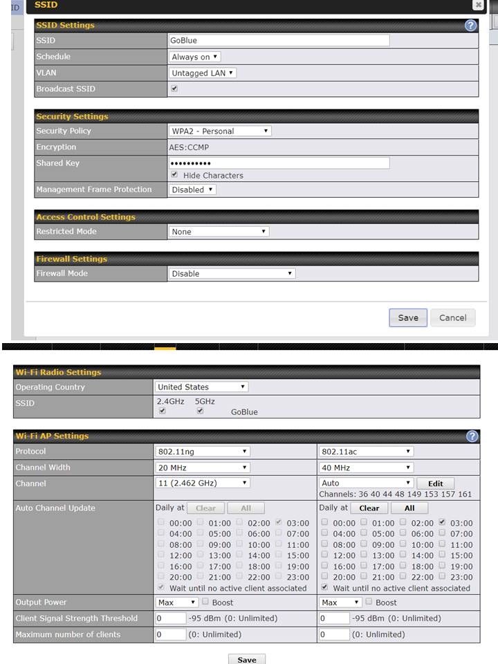

Not much success yet. Hard to tell when I check the speed and its 40+MBPS and 5 minutes later it’s 10 MBPS. I’ve attached a few screen shots of my configuration, all of the items that seem to be relevant.
What I’m a little confused about is we log into the WiFi which is named “GoBlue” but on the dashboard it says “Disabled” and the GoBlue Wi-Fi AP is on. Also, when I go to the status tab it shows all active sessions are WAN not GoBlue.
Resetting is an option, but I a little unsure now that I could set this all back up. Yes, I know about down/up loading configurations, but seems like then I be just back to where I am now.
Thanks for all the help,
Bob
I think his settings look good - except for…
Dashboard>WAN>Details>Download 100Mbps
I believe you originally stated your connection was 200Mbps. Set it to 200Mbps and see if that does it?

I would also change 5Ghz Channel Width to 80Mhz to get better performance…
AP>Settings>Channel Width>80Mhz
