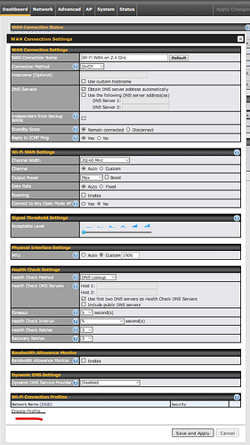

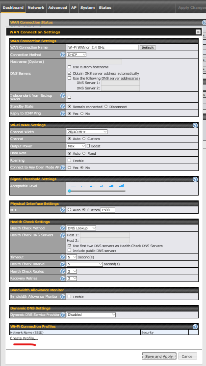

Open the Wi-Fi WAN on 2.4Ghz>Details. Then click on Create at the bottom.
Preconfigure the Wi-Fi WAN on 2.4Ghz with the hotspot name, network type and password so its ready to connect as soon as you open the hotspot. This is important because the iPhone hotspot will go to sleep within 2 minutes if nothing connects to it. Select “obtain DNS server address automatically” as it helps it connect faster. Everything was otherwise left at default settings as shown in the screen shot(s).

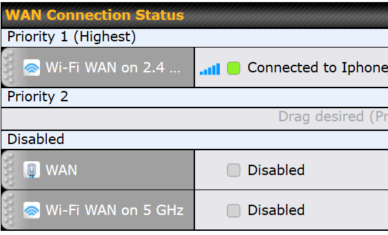

Drag and drop the WAN connection down to the disabled area (or Priority 2 if you prefer).
Drag and drop the Wi-Fi WAN on 2.4Ghz up to the Priority 1 position.
It will commence scanning.
Turn on the hotspot.
It will check connectivity and then connect.
