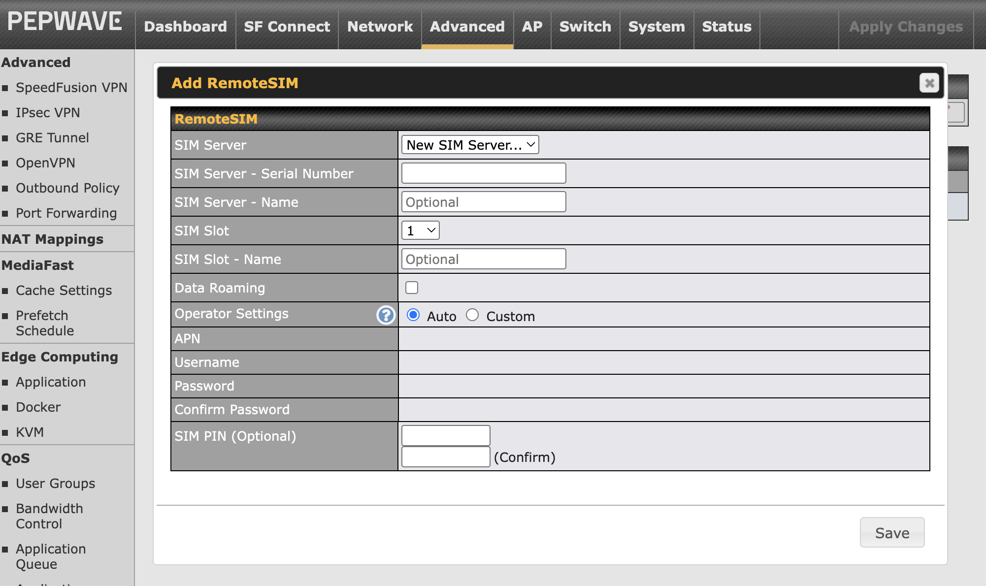

We shall see what we can do on the coming 8.6.0 release. On the device with SIM Injector on LAN, we can add the SIM PIN on the local setting shown below. This needs to be fixed since the current release is not working at the moment.

Not on 8.6.0 RC 1 but we shall have RC 2 coming up. We are still trying to get this in 8.6.0 before GA.
any idea for a timeline?
You can use the coming 8.6.0 RC 4 which we have fixed that. :wink:
