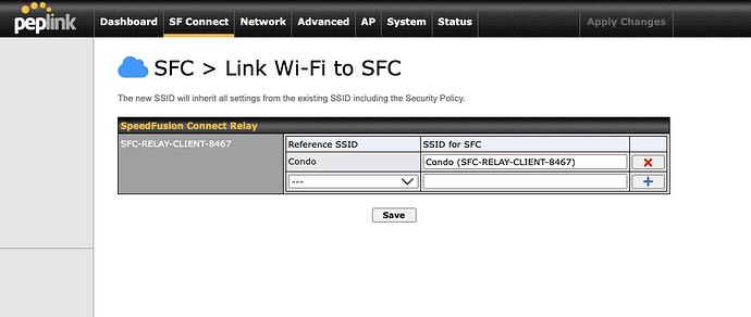

The traffic on the Condo SSID doesn;t seem to be routing through the relay. The SSID for SFC “Condo (SFC-RELAY-CLIENT-8467)” has no internet connection. I have followed the configuration instructions but must be missing something.

I then used the SFC, Outbound Traffic Steering Priority to configure a separate wifi network to utilise the relay (Route by Wi-Fi SSID option).

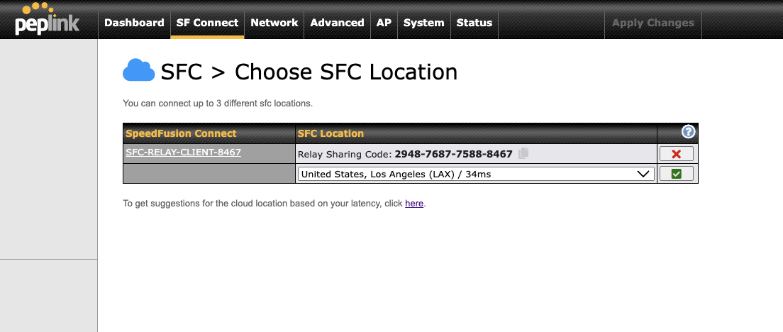

Based on your note, I’ve also set-up the MAx BR1 Pro 5G as a relay for inbound and outbound access and have sharing codes for each, but don;t know where to put them. I can see both devices in Incontrol and can access each of them.
I’ve also configured the BR1 for relay mode - for inbound access using the closest SFC servers in DFW, but that doesn’t seem to do anything other tnan generate a new sharing code for the router.

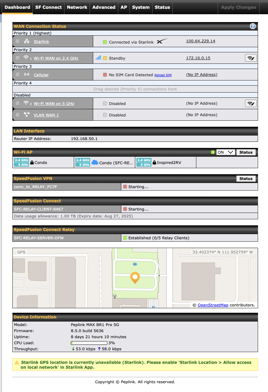

Can you include the current dashboard status of the br1 pro , and the SFC?

and here is the dashboard of the BR1

Are you able to connect the sfc relay hrough DFW sfc ? I see the BR1 pro says it’s connected?
