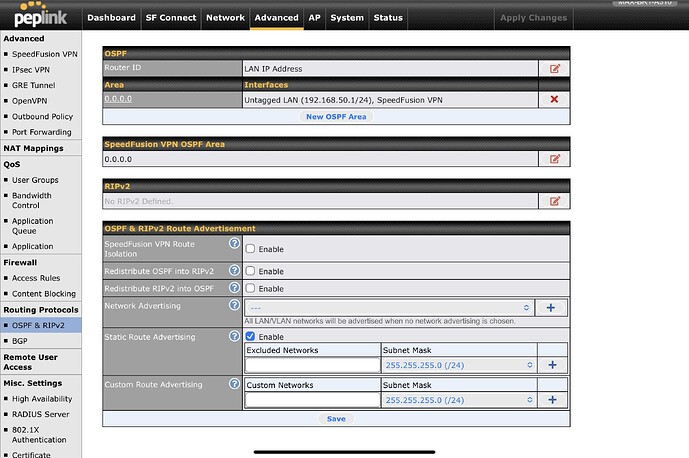

I am going crazy, I have SpeedFusion relay set up on a BR2, I have a client node (A BR1) connected to it. I’ve looked at everything, I don’t know how to route, or just set up a basic layer two bridge so a LAN client on each device can talk to each other! Any advice would be great.
I have an OSPF area which is just the SpeedFusion VPN, I also tried adding my local LAN interface on each device to the OSPF area. I’ve specifically advertised each LAN network on each Peplink. I’ve forwarded the appropriate ports on the router on the uplink or the BR2 and I used nmap to ensure the ports are open.
Note I don’t have incontrol. Spending 600+ AUD on a subscription for a thing that I’ve already bought another subscription for, as well as the initial 12000 AUD purchase. Does not sit right with me.
Note I have both the local LAN and Speedfusion VPN selected as interfaces on the same OSPF area. I have zero rules set for firewall inbound and outbound traffic other than the default.
