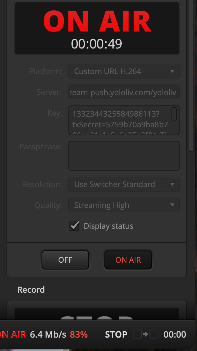

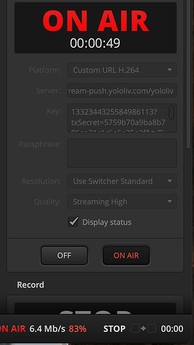

Im sending a RTMP stream from an ATEM Video encoder.
Approx 6Mbps upload.

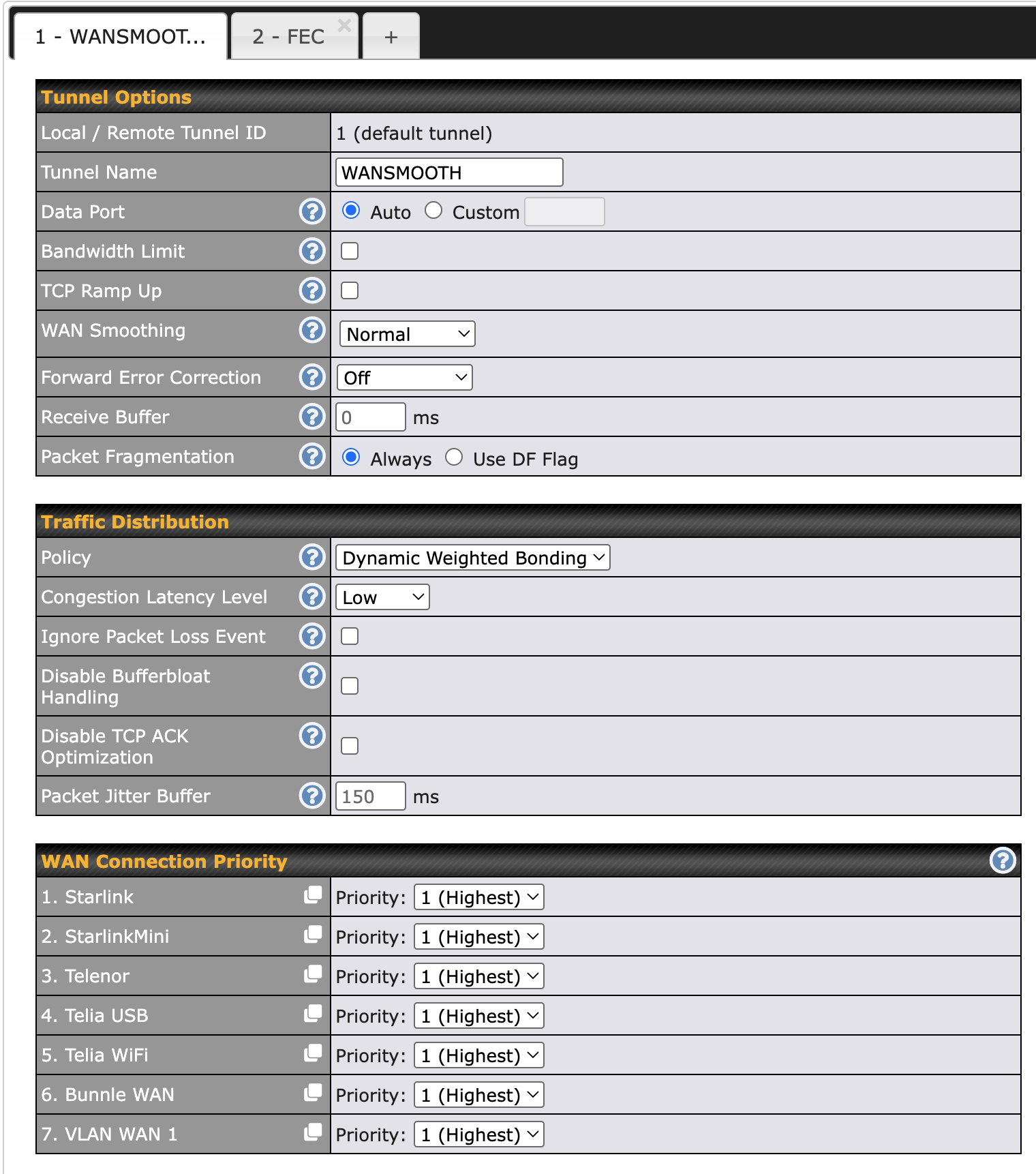

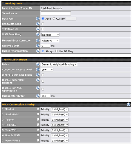

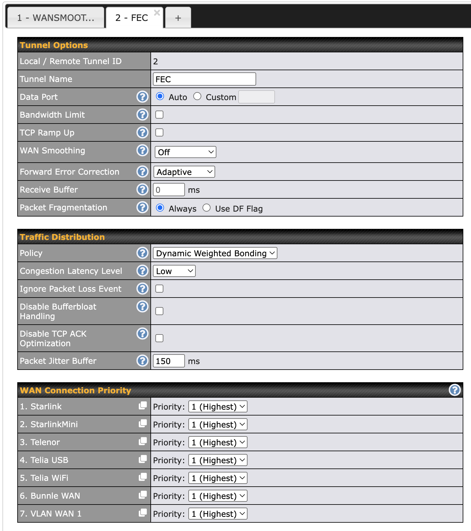

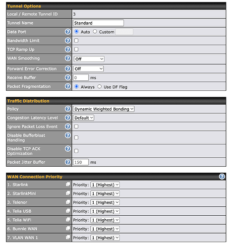

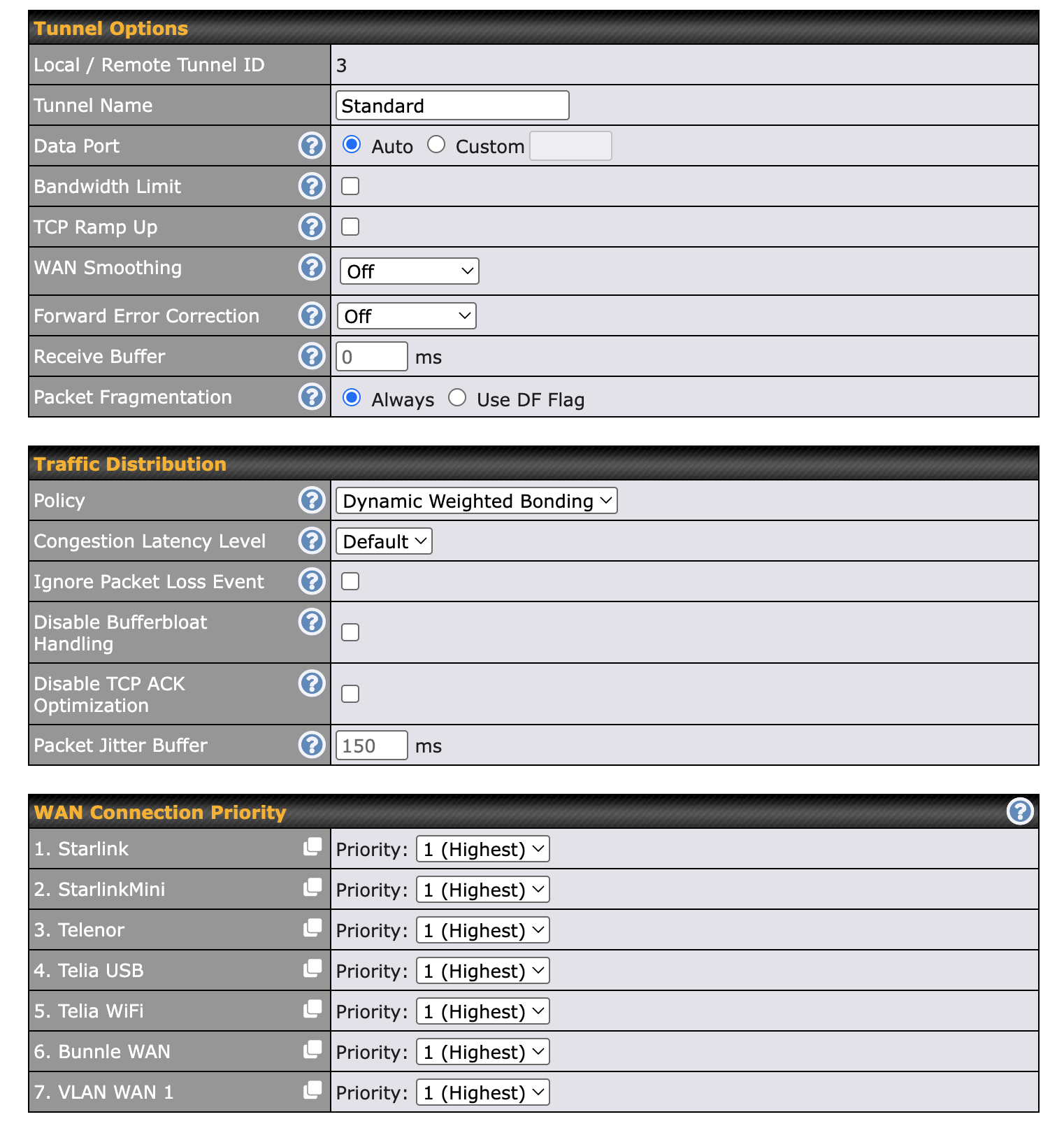

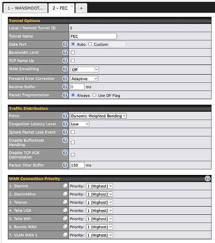

3-4 different profiles Ive tested after reading tips here on the forum.
WANSMOOTHING
FEC
Standard

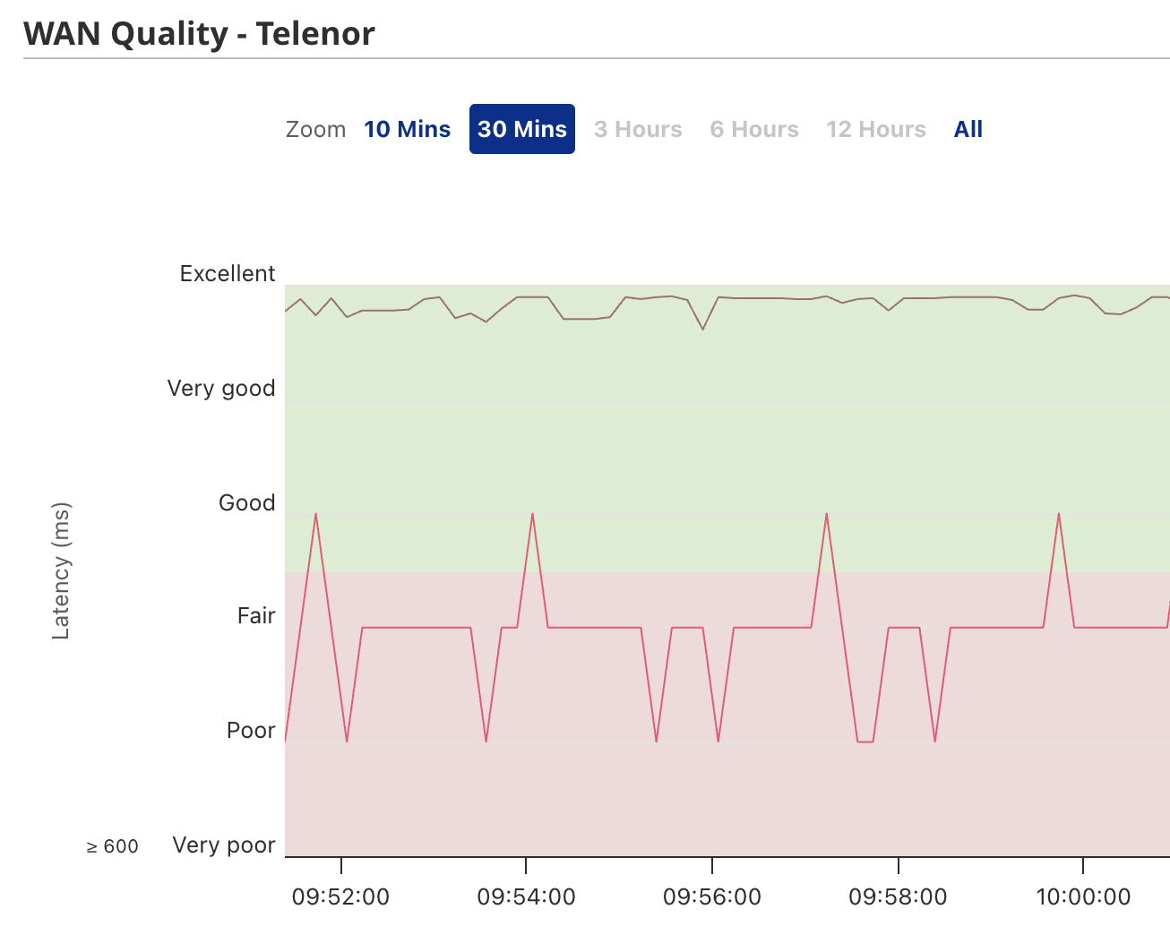

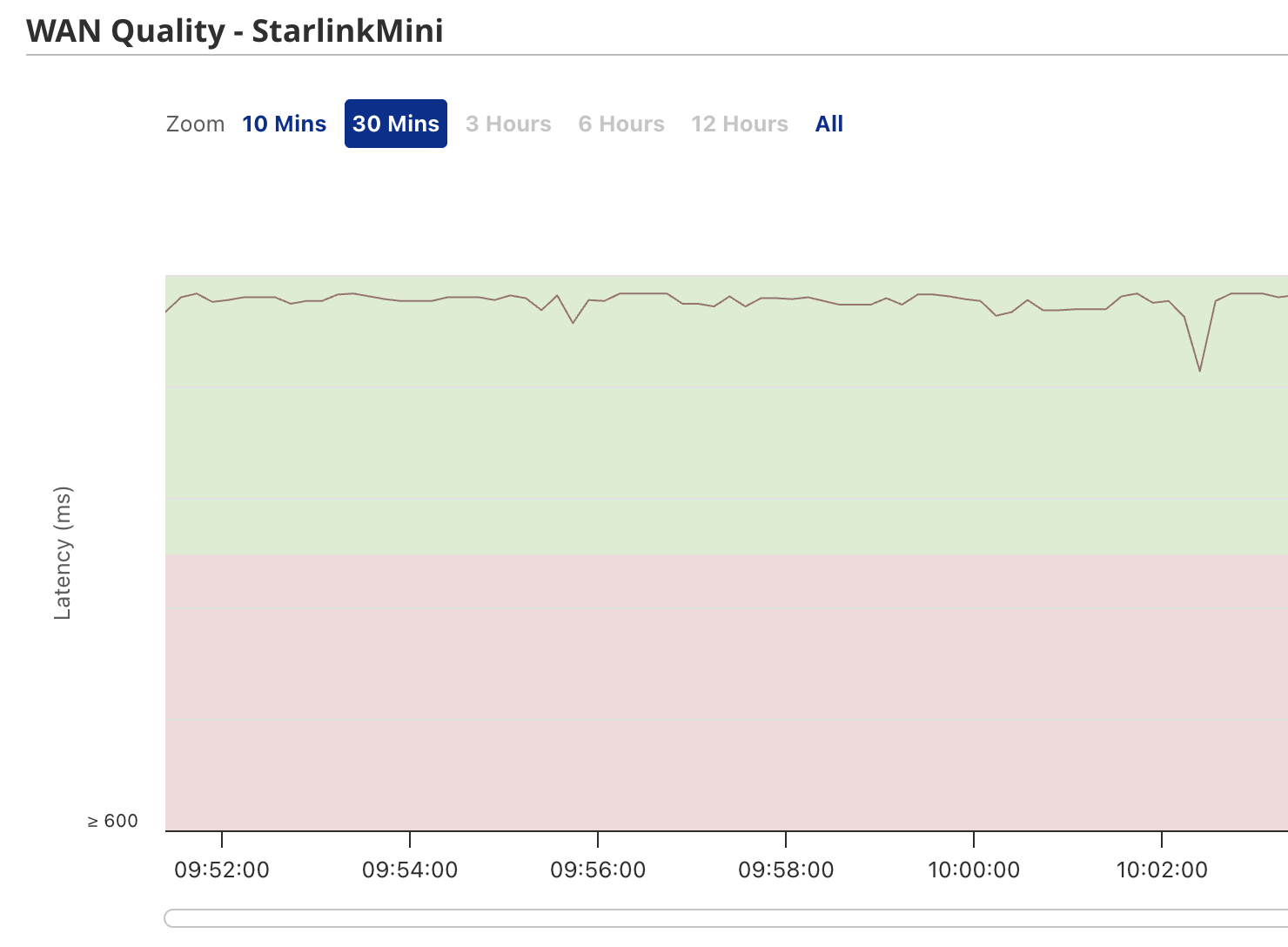

I have stable connecetion according to Incontrol on all 3 WANs
However, sometimes the stream seams to get congested. (The ATEM starts buffering til the point it stutters online). See the bottom line.

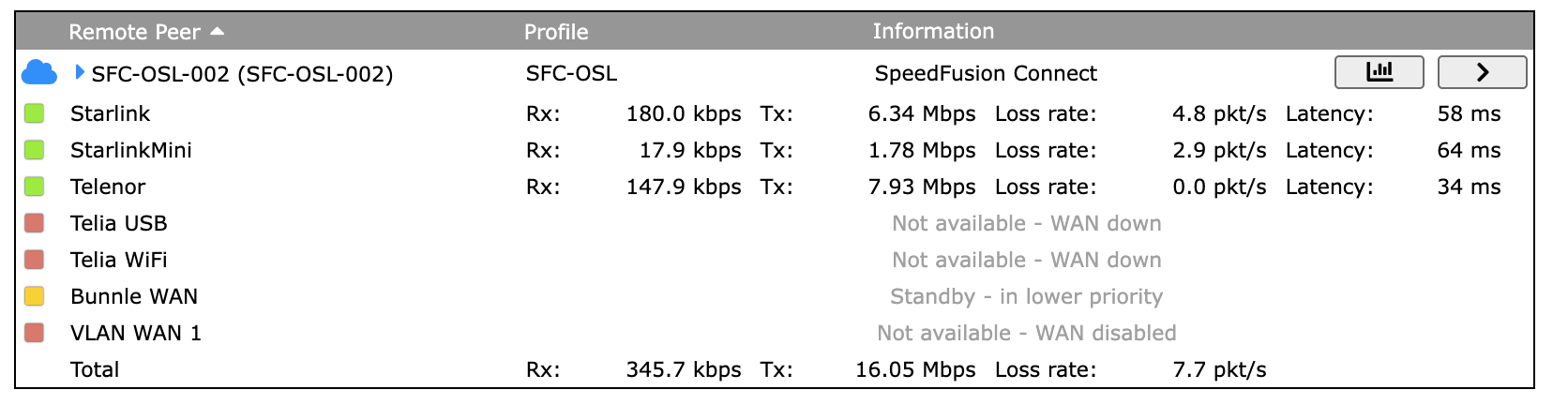

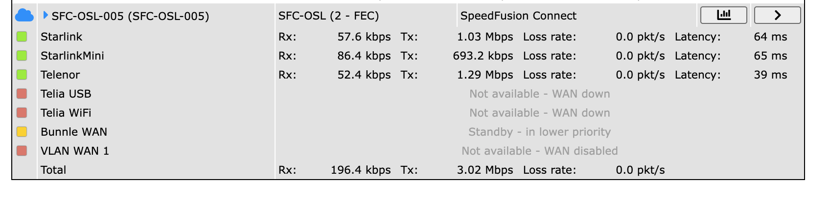

When monitoring the SFC VPN it seems like the traffic outbound is around 50% of what is pushed out of the ATEM. 6Mbps → 3Mbps.
This happens also when doing WANSmoothing or Standard profile.
But NOT always. Thats what drives me nutz.

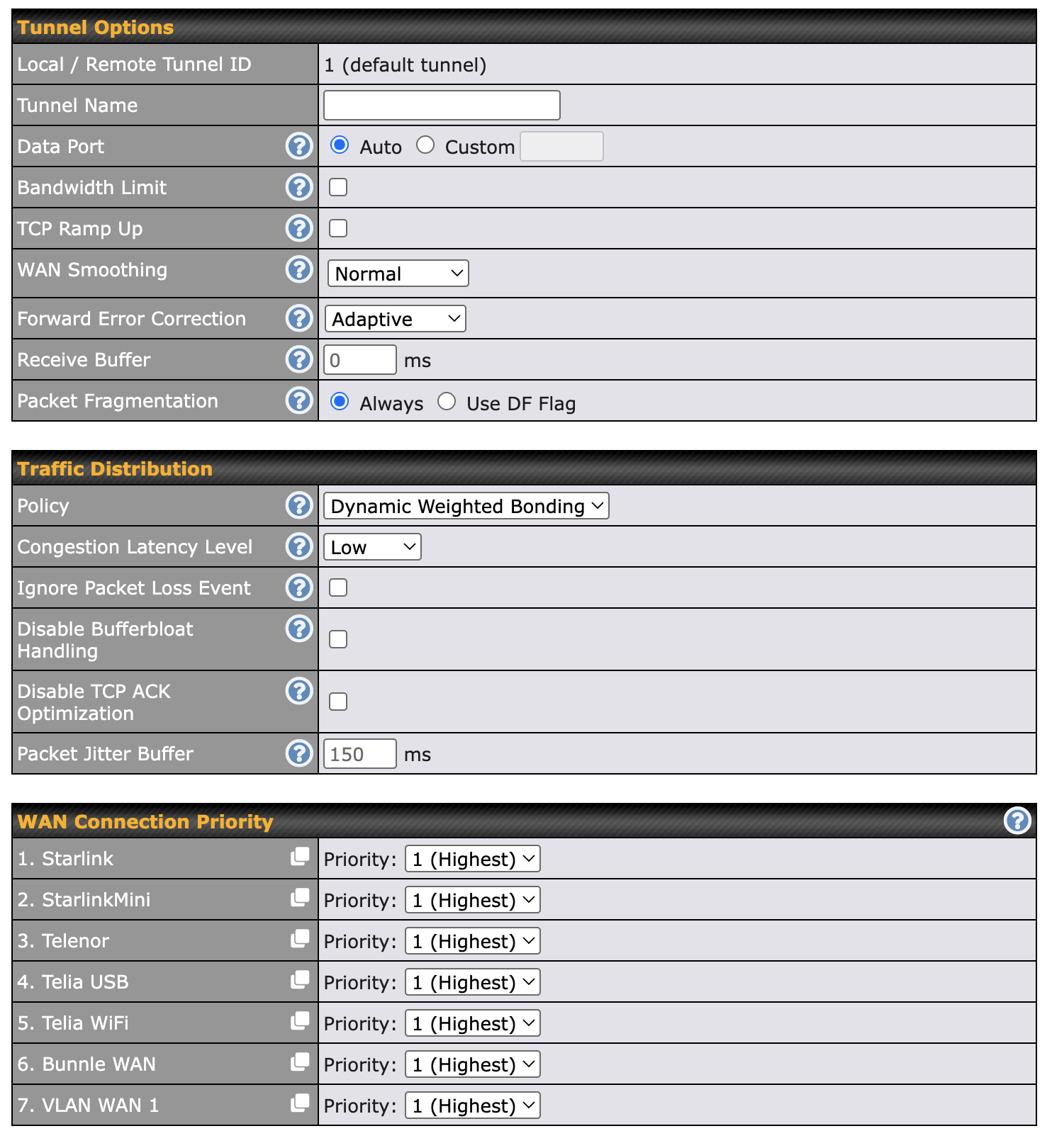

It does work If I use Wansmoothing and FEC together.
But that will demand a lot of bandwith on both Starlinks and the 5G, and in some areas Im sceptical if I will have 5G coverage.
Trying the FEC alone doesnt seem to work for me.
