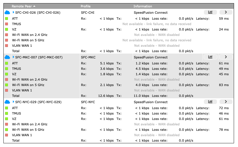

My WAN config has evolved since the original post, but the behavior continues, even with a new B One router and 8.6.0. The attachment image actually looks relatively good compared to most times. Usually, the “TMUS” WAN (BR1 Mini 5G) is not available on any of the SpeedFusion Connect links, and almost always even when it is available on SFC 2 and 3, it is still not available on SFC 1 (Chicago). All of these links work fine directly, with good response and good bandwidth.
the “VZ” WAN (USB) is usually pretty good, “ATT” drops off one or more SFC occasionally, TMUS and the Wi-Fi WAN drop off the most, sometimes on one SFC, often on multiple or all.
The intermittentness, and the fact that one or two SFC might be fine, but another isn’t, leads me to think that there is some firmware issue or issue at the SFC hub location, probably among other factors. Why would a given WAN be fine on one SFC peer but not another?

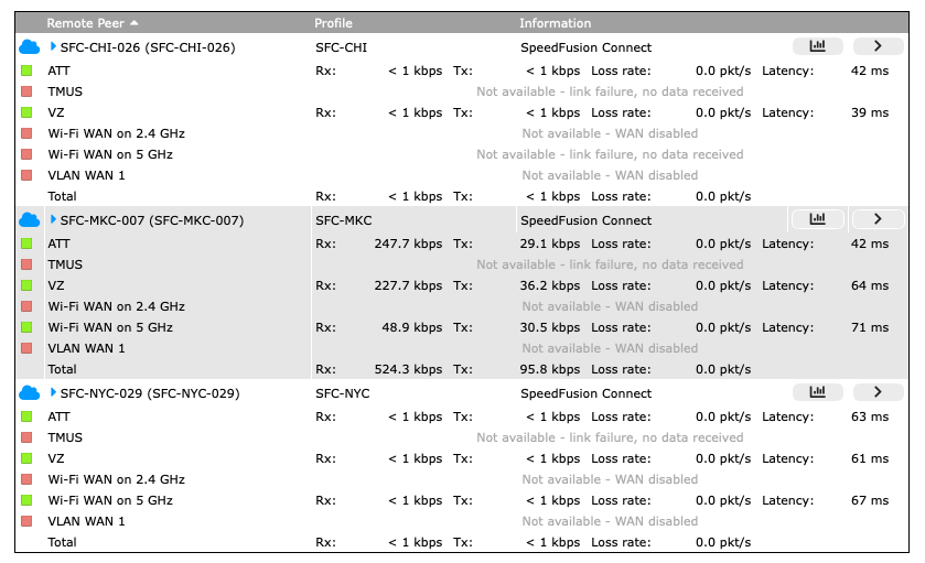

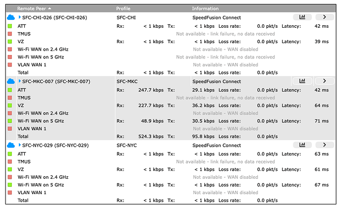

You can see that, this morning, “TMUS” has dropped off of all SFCs, and “Wi-Fi WAN on 5 GHz” (ATT) is still/again dropped off of the Chicago SFC:
