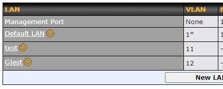

We have a 24 ports SD switch with firmware 1.2.3 build 260, where I want to implement 802.1X VLAN assignment.
The authentication works fine, but the switch always put me in the default vlan.
This is the attributes my radius server return:
Tunnel-Type = VLAN,
Tunnel-Medium-Type = IEEE-802,
Tunnel-Private-Group-id = 12
When I look in the help for “Authentication Method”:
Anyone that have a clue what I do wrong?
