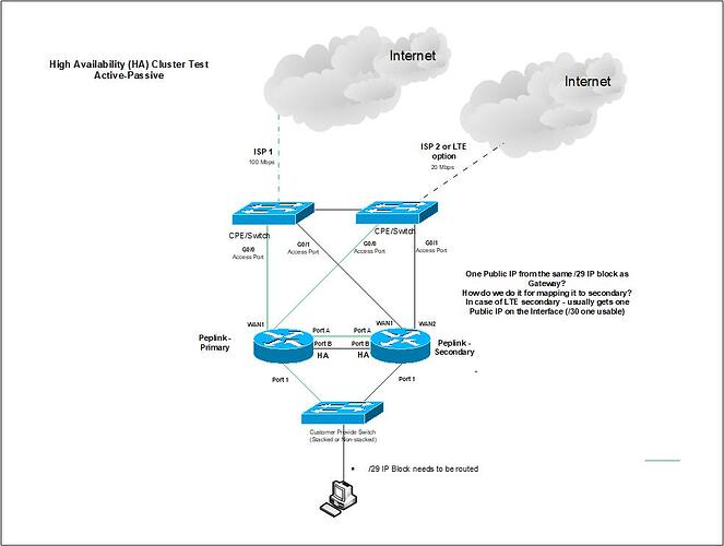

I have a specific situation, I got two circuits - Fiber 100/100 Mbps and Cable 20/20Mbps. Fiber needs to be Primary and Cable is secondary. My requirement is, I need to use a /29 Public IP internally which is provided by my Primary fiber provider. If primary fails the same /29 must be routed ( NAT is not an option for me) using the cable. I think I cant achieve this using a regular cisco router unless I configure complex BGP configuration.
In some specific situations I don’t have a secondary Cable, LTE is the only option. In such situations how can I achieve using the same /29 IP block.
I’m adding a design with HA in mind is it possible to achieve this?

Regarding “If primary fails the same /29 must be routed ( NAT is not an option for me) using the cable.” - the issue would be that the cable provider would likely try to route traffic via ISP 1’s network, which wouldn’t be working. ISP 2 would likely just not have a direct route back to your /29 network. It’s not something that could be solved within your setup (other than using BGP or NAT).
Other than that, the setup should work correctly.
As @Aivaras_Priudokas highlights, for the same /29 subnet to be available across all connections and multiple operators you’ll need to advertise that /29 in a way that all ISPs can route to it. However most ISPs will only accept and propagate /24 prefixes. /29 will be too small.
If you’re lucky, you can sometimes find a single ISP that will offer internal inter service routing (between their own Fiber / Cable / LTE services) using BGP. Then you can advertise that /29 from both routers on all connected services you buy from that ISP and chose which routes you’d like to prioritise (ie Fiber > Cable > LTE).
If you do that this way though you’re tied to a single ISP which is in itself a single point of failure (even when they say they are not :slight_smile: ) and you can’t guarantee the ISP will have multiple services everywhere you need them.
If you want multi-operator and multi-technology resilience then you’ll need to buy and advertise your own /24 block of public IPs using BGP to your connected ISPs (or get a /24 block from ISP A, request a LOA to advertise them, and pass that to ISP B). Its perhaps more complicated than it ought to be (especially finding clean IP blocks that haven’t been abused) but doable if your ISPs will accept the prefix and propagate it - not all will.
