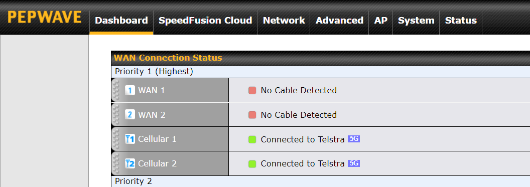

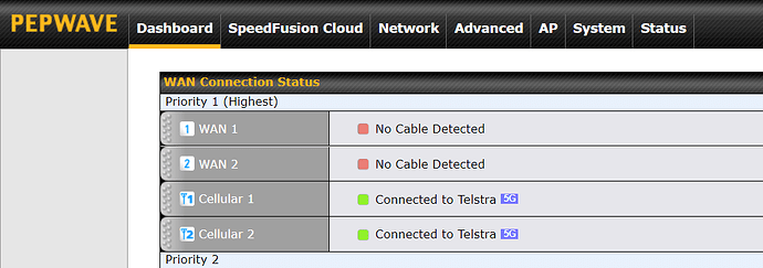

The 5G icons showing is depending the tower returned info. Some telco may not return the expected value and the cause the icons showing LTE only. For some Cell tower that returning the expected value, the module do showing the 5G icons. Below are some tested 5G connection showing status.
Possible please help to raise a ticket if you see the 5G /LTEA icons is not showing as expected. We will check from the device to confirm the issue.
