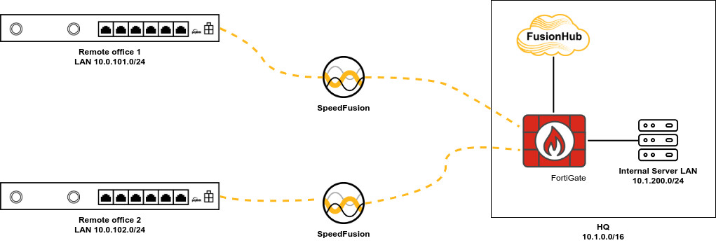

In the simplified situation below, I have two branch offices connected to the HQ using Speedfusion tunnels. The real situation is of course far more complicated, with more remote offices, and where the central FortiGate firewall cluster handles all traffic between all VLANs together with more in-depth security features and filters. Speedfusion tunnels are set up to connect remote offices due to all advanced Speedfusion features like bounding, FEC, WAN Smoothing,…
How can I make sure clients in remote office 1 can also reach services in remote office 2 (and vice versa) but only when passing and being filtered through the FortiGate firewall? It would require the possibility to create an outbound policy rule in the FusionHub where traffic can be routed depending on the incoming network interface and not only the source IP address.
