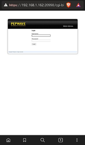

When I connect directly to the pepwave web interface, what is the password requested?
that of the peplink balance 20 or that of the default of the pepwave?
Maybe you should show is a screen capture of the subject location?
Hi,
YYY
It is the password of the pepwave AP… but if the AP is/was managed by the Balance 20, then the balance 20 owner can tell you the PW.
This is found on the B20 under the AP tab then “setup” Select the configuration (default?). Halfway down the next page will be "web administraion settings (on external AP). You then “unhide” the admin password.
Well, OK, you appear to be at the log-in screen of the AP. The AP is likely that set by the B20. The specific router that was used to configure the AP is not relevant at this point – UNLESS you have access to it and get it to communicate with the AP. Other than that, and failing the suggestions put forth by @dennis.hofheinz and @Jonathan_Pitts , I’d say you are outta luck. :<(
