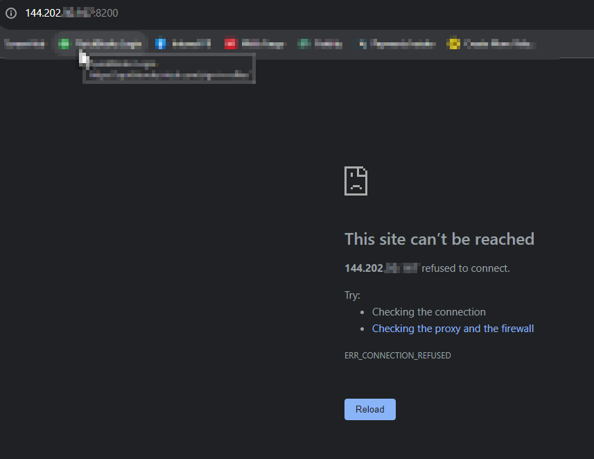

From here, what I’ve done (right or wrong) is to go the the Vultr provided interface IP in my browser with the port 8200 appended at the end. And I get connection refused. So, for example, if the hypothetical interface IP was: 144.200.50.160, I entered 144.200.50.160:8200 in the browser. And every time, it is refused.

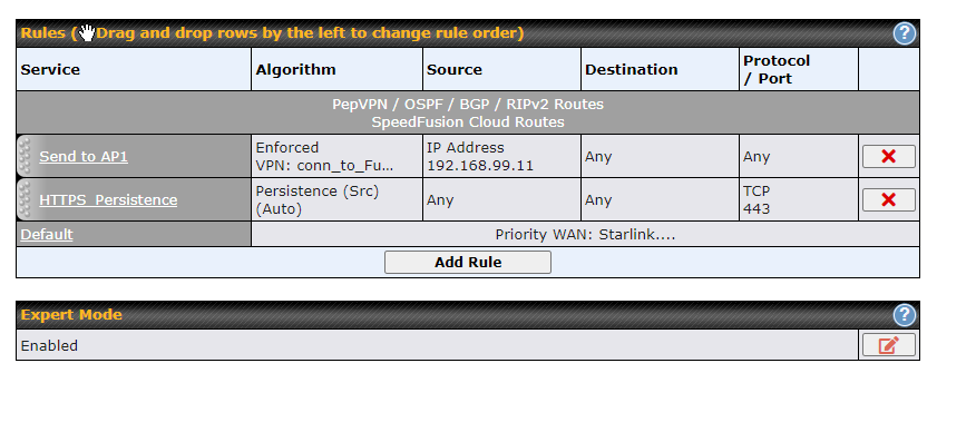

  3. Outbound policy is set as noted:
I wasn’t sure of the next steps, but I tried to go to the WAN IP Address for Speedfusion device again in my browser, I received the same issue with the port 8200:

Just a quick note to say that we took a closer look at this and got it working.
We changed the port forwarding rule on the fusionhub to a port mapping type and used a port other than 443 which is what the FusionHub Web Interface was sat on and mapped it to 443 on the test device ( a AP on the LAN).
