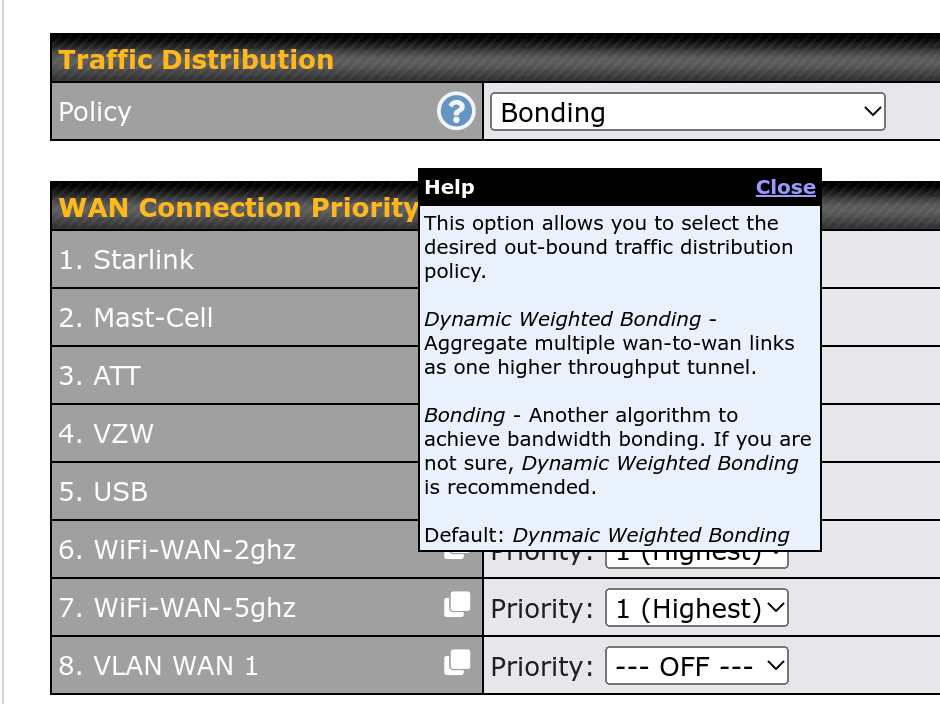

Traffic that is going through a Speedfusion tunnel you dont get as much granular control (within the tunnel). The tunnel can be configured to use both active-active. Or you can make it active-passive. The tunnel has a choice “bonding” or “weighted bonding”. Weighted bonding doesnt have the same slider controls as weighted balance. I have tested both and find bonding gives me more total raw speed.
Here is the difference between the two
