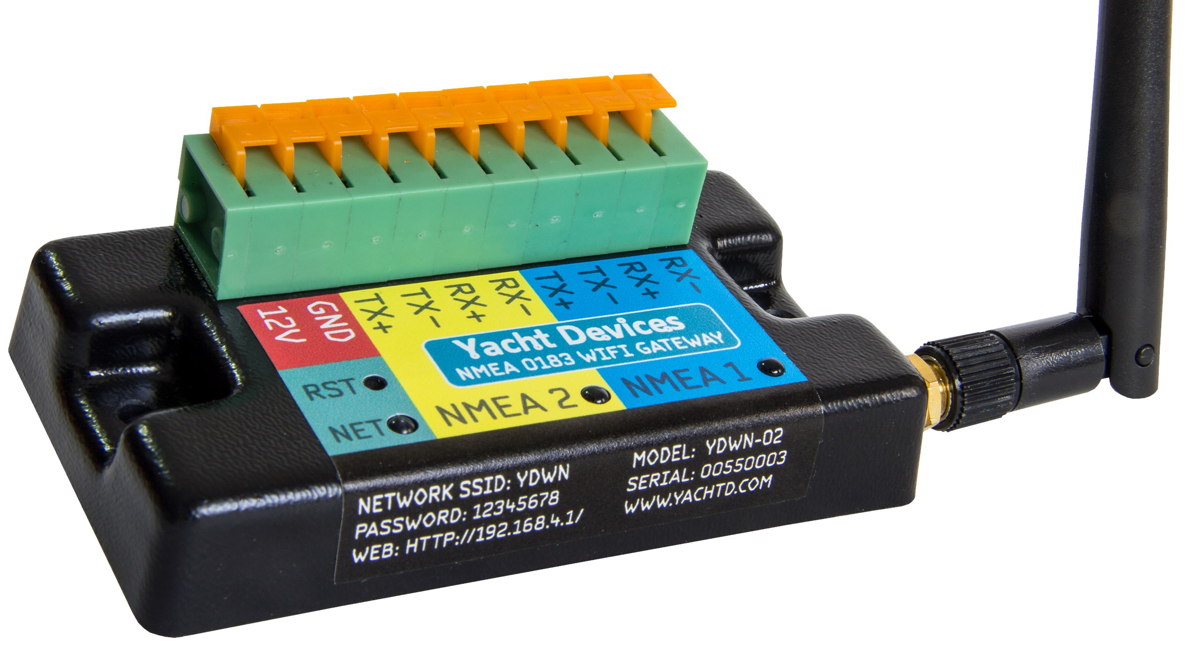

Depending on your setup onboard I would use either,
Starlink
YachtDevices or Digital Yacht device to transmit GPS via UDP/TCP to Router
Some MFD systems also allow for outputting NMEA 0183 data which would work for you.
USB Devices such as GlobalSat is not recommended, better you use your vessel navigation GPS instead (more precise too!).

For this use case - I would recommend you get a NMEA0183 device to network and forward via UDP or TCP to the router.
I have not tested any USB GPS with the new B One units.
Or this one,
https://actisense.com/products/pro-ndc-1e2k/
https://actisense.com/products/pro-mux-2/
Would do the trick for you.
