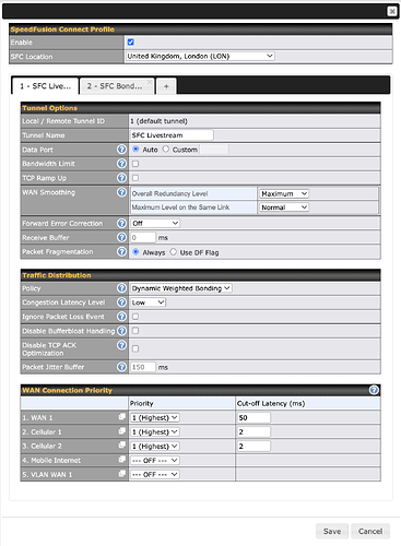

However, you can use latency cut off as a way to achieve what you want. Put all WANs in the SFC tunnel, then set the latency cut off on all WANs.On the ones you want to use in the tunnel set them at a sensible level, on the WANs you don’t want to use set the cut off lower than they can achieve. This affectively removes them from active use in the tunnel - whilst keeping them available to be used in the tunnel.
When the primary WANs fail (or their latency rises above the cut off values set), since all active WAN latencies will be over the cut off value, the other WANs will be used. And you’ll have hot failover that reacts as fast as the latency measurement.

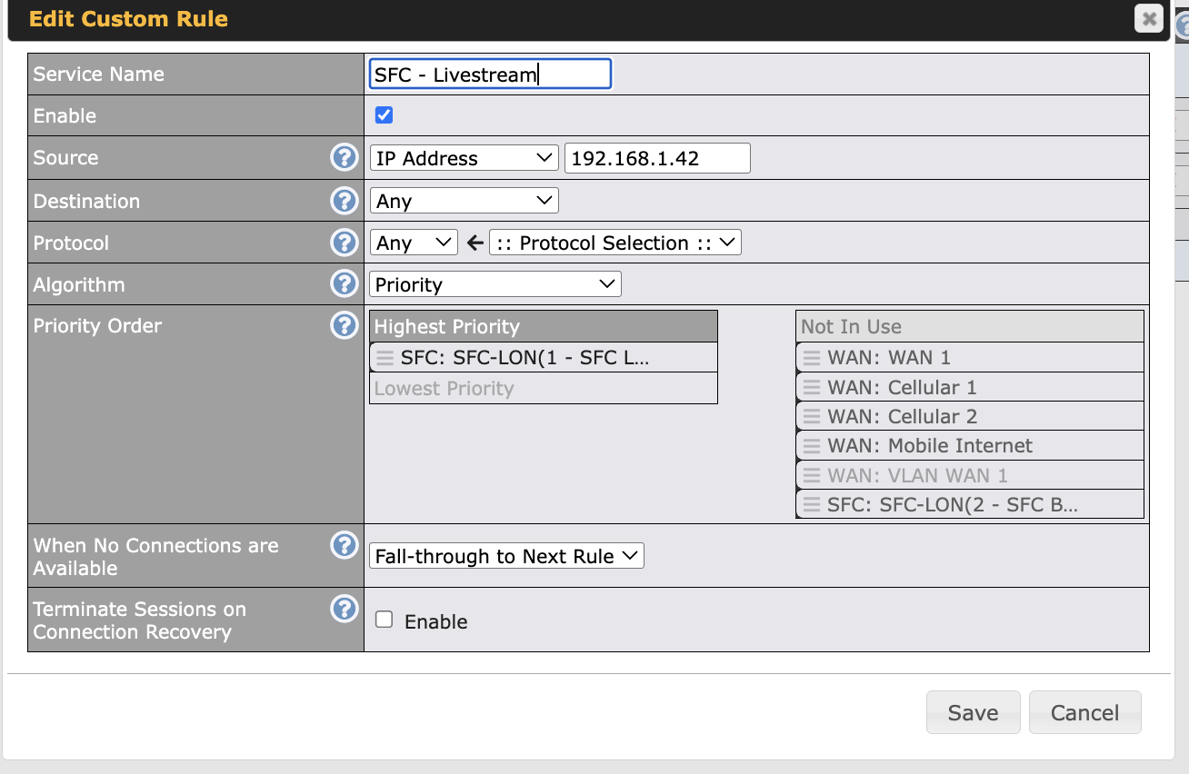

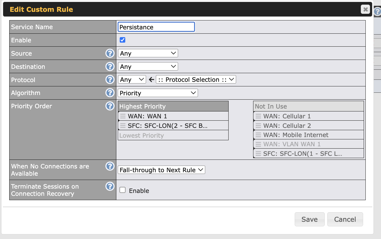

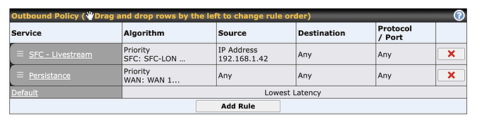

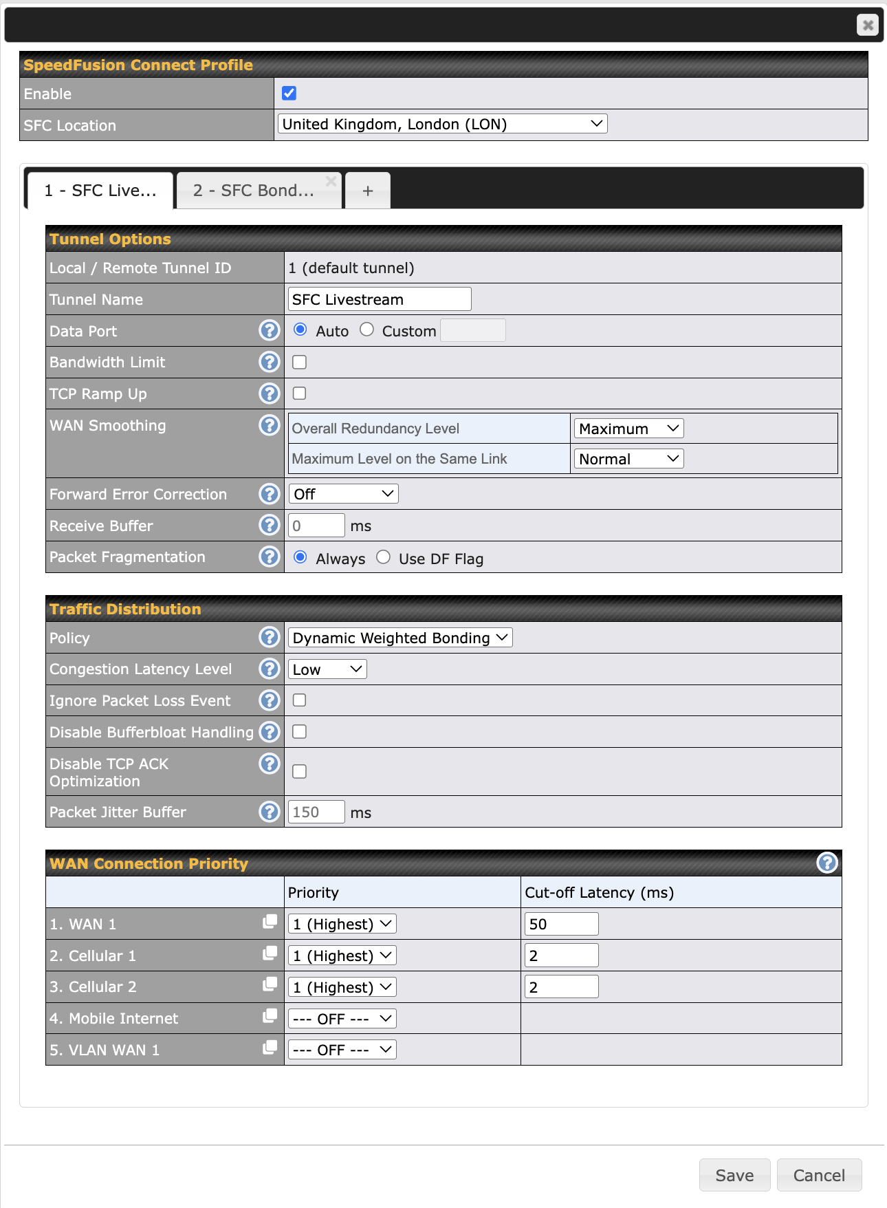

Best share some screenshots with your settings so we can review them.
Hi Martin,
Thanks for your help
SFC - Livestream is what I used for testing - sub-tunnel 1
This is indeed a very good way of setting WAN interface priorities in Speedfusion tunnels which I used a lot on much appreciated suggestion of Martin.
For SFC with its 6s failure detection there is one big drawback: when your preferred link is saturated, the traffic will be re-routed over the “backup WANs”: the ones with the unreachable low latency limit. This causes a drop in the traffic of the preferred but saturated WAN, which might in turn cause again a drop in its latency or packet loss, causing again (after 6s) a switch back to this preferred interface and thus a 6s endless switching loop…
