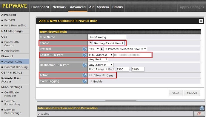

I am looking for a wired router with schedule-based access control with MAC and port specification.
Specifically, I want to block specific ports used by gaming sites for specific local users at certain times of the day.
Can the Surf SOHO router do this?

The Surf SOHO should fits to your requirement, assuming the environment is Home or Small Office setup with up to 25 users.

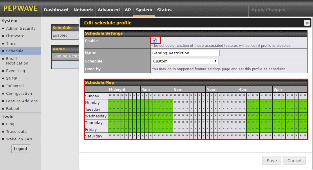

Two steps needed to achieve this functionality:
  1. Define the schedule.

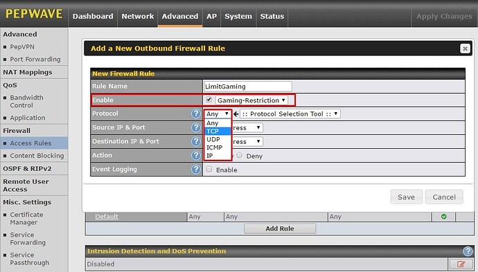

  1. Create the Outbound Firewall rule(s) with the schedule defined above. You may need to create multiple rules depends on your blocking criteria.
a. Select the Protocol
b. Input the Gaming machine MAC Address
Hope this helps, or you can refer to the firmware 6.3.1 user manual for more details.
