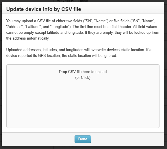

Hi Noah, Christopher,
Would the following feature suit your purposes?
It can be found just below both the organization and group level device lists as “Update device info by CSV file”
(For group level, click ‘edit’. For org level, make sure you’re in ‘devices’ mode)
We’ll take a look at making a public version of the api, but this is current available in production.
