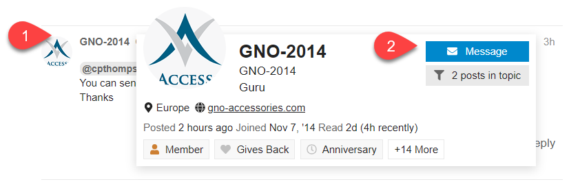

Hi. I’m not sure if this is how you send PM?
Click on Sams username then click the message button that pops up
