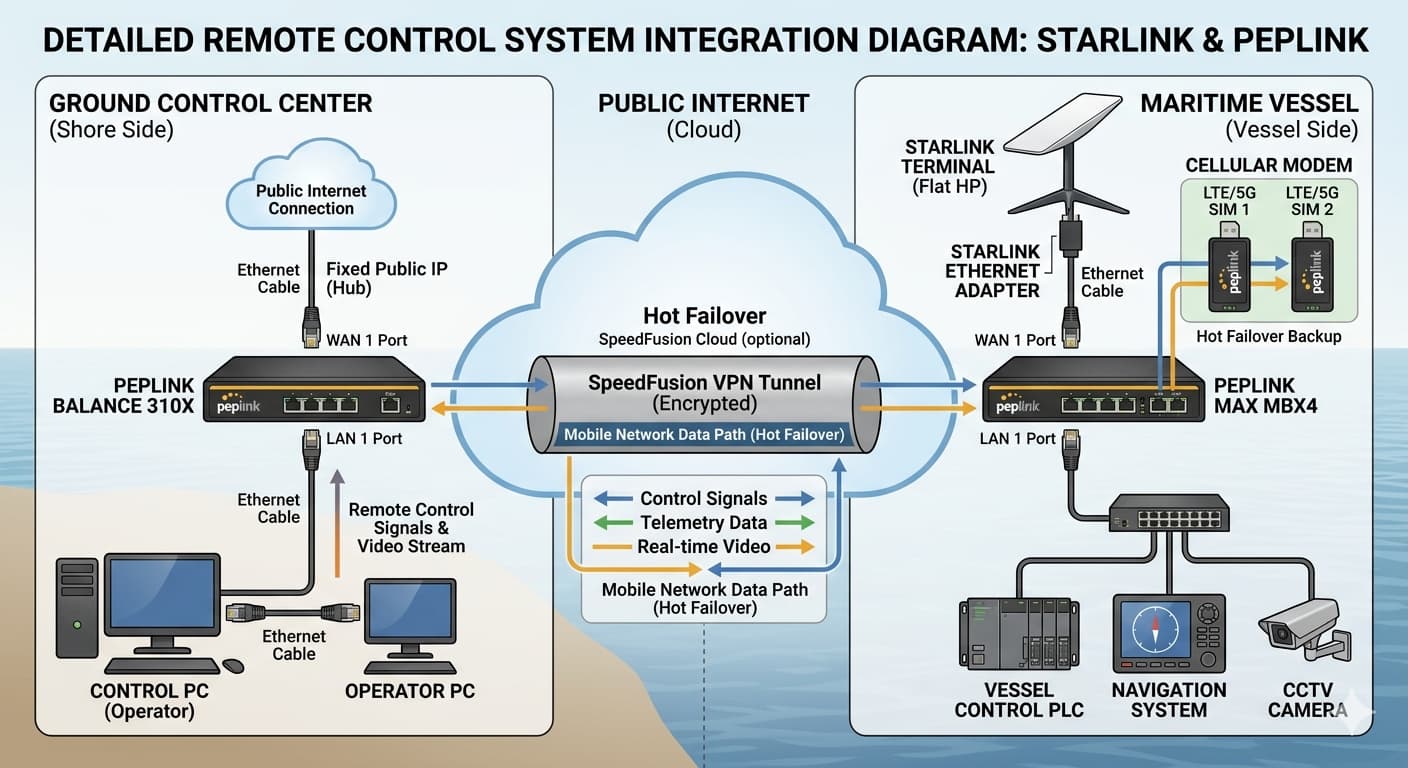

I need your help.
It is intended to be used in situations where there is a balance equipment at the ground control point, and MBX4 is present on ships in remote seas. At sea, I want to use Starlink and use Starlink to control the ship remotely from a remote place. The configuration diagram for this was uploaded to the attached file. Please check whether this configuration is reasonable for the purpose, and please recommend a product configuration suitable for the purpose that the customer intends to use.
Note (with a total of 2 bonding routers)
Ship side: 3 LTE lines for sea + 1 Starlink line (to be expanded in the future)
Remote Station Side: General 5G 2nd Line for Land Use (to be expanded in the future)
※ In case of LTE for sea use of ship, connection is required through separate antenna and router
How did you make that diagram? its very nice. Was it AI?
What size is the Ship? is it small and uncrewed? Or large with many decks?
