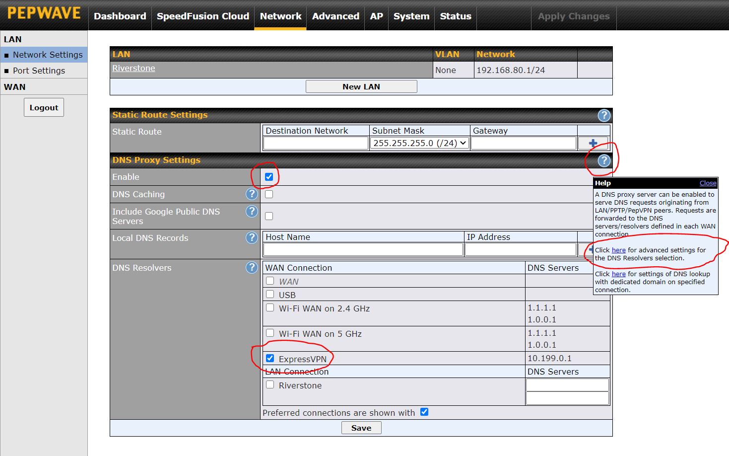

  2. Go to NETWORK/LAN/NETWORK SETTINGS.
  3. Under DNS PROXY SETTINGS, check ENABLE.
  4. Click on the Help (blue question mark), and then click on "Click here for the advanced settings in the DNS Resolvers selection"
    . Then select your OpenVPN interface (mine is labeled ExpressVPN).

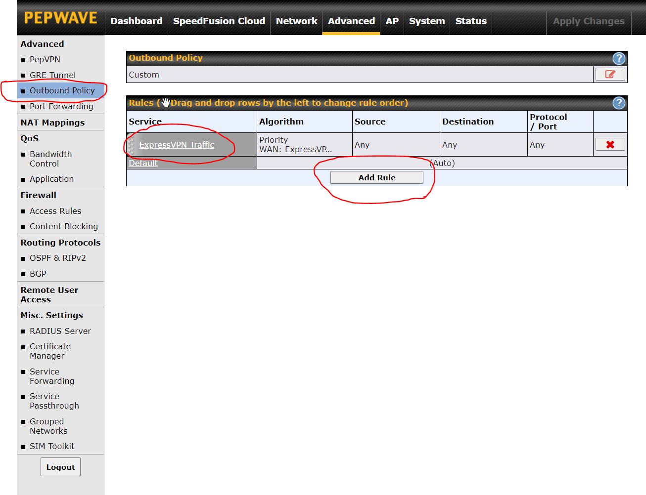

  5. Go to ADVANCED/ADVANCED/OUTBOUND POLICY
  6. Add a new rule.
  7. Check Enable box, select OpenVPN (I labeled mine ExpressVPN), then choose When No Connections are Available. See options.
  8. Check to ensure traffic is flowing through the VPN tunnel, by going to STATUS/USAGE REPORTS/REAL TIME. Observe the traffic

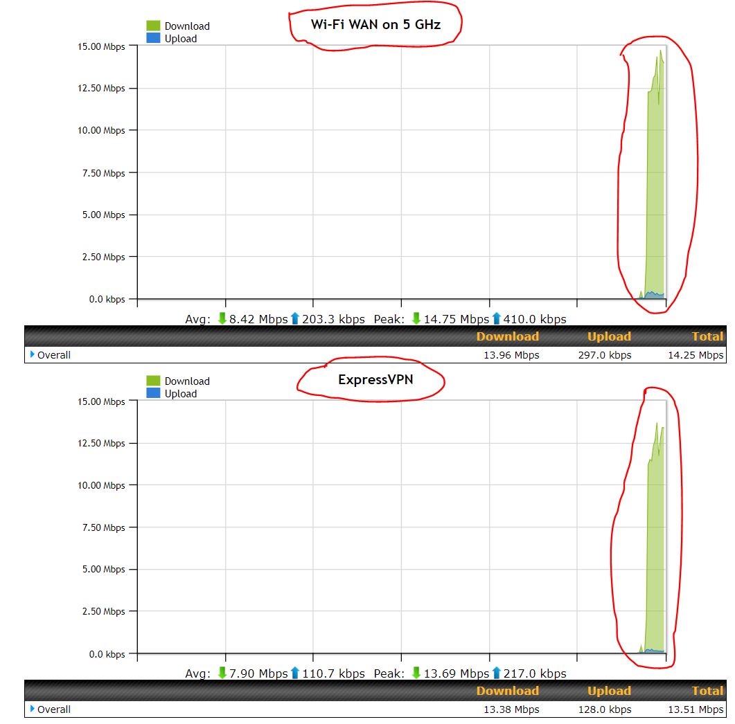

In addition to the 10-12 Mbps speed limitation, it is also pegging the CPU at a constant 100% at that speed.

Can someone tell me if this is still an issue with max or very high CPU usage when using the OpenVPN client and the Surf Soho MK3?
I wanted to see if it was even worth getting the OpenVPN client or not for the Surf Soho. I’ll be video streaming on one device. The 10-12 Mbps limitation is kind of a bummer to hear about.
